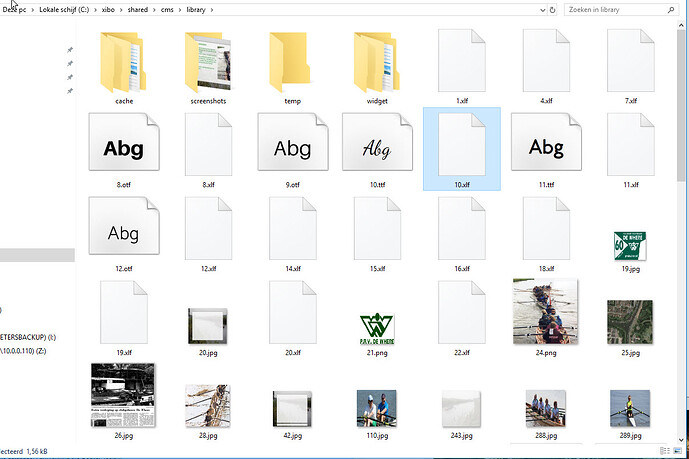

Once logged in, I discovered that al my layouts, campaigns and other settings were gone. I don’t know why.
Looking in the folder C:\xibo\shared\cms\library shows me all the data is still there:
