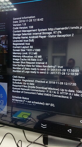

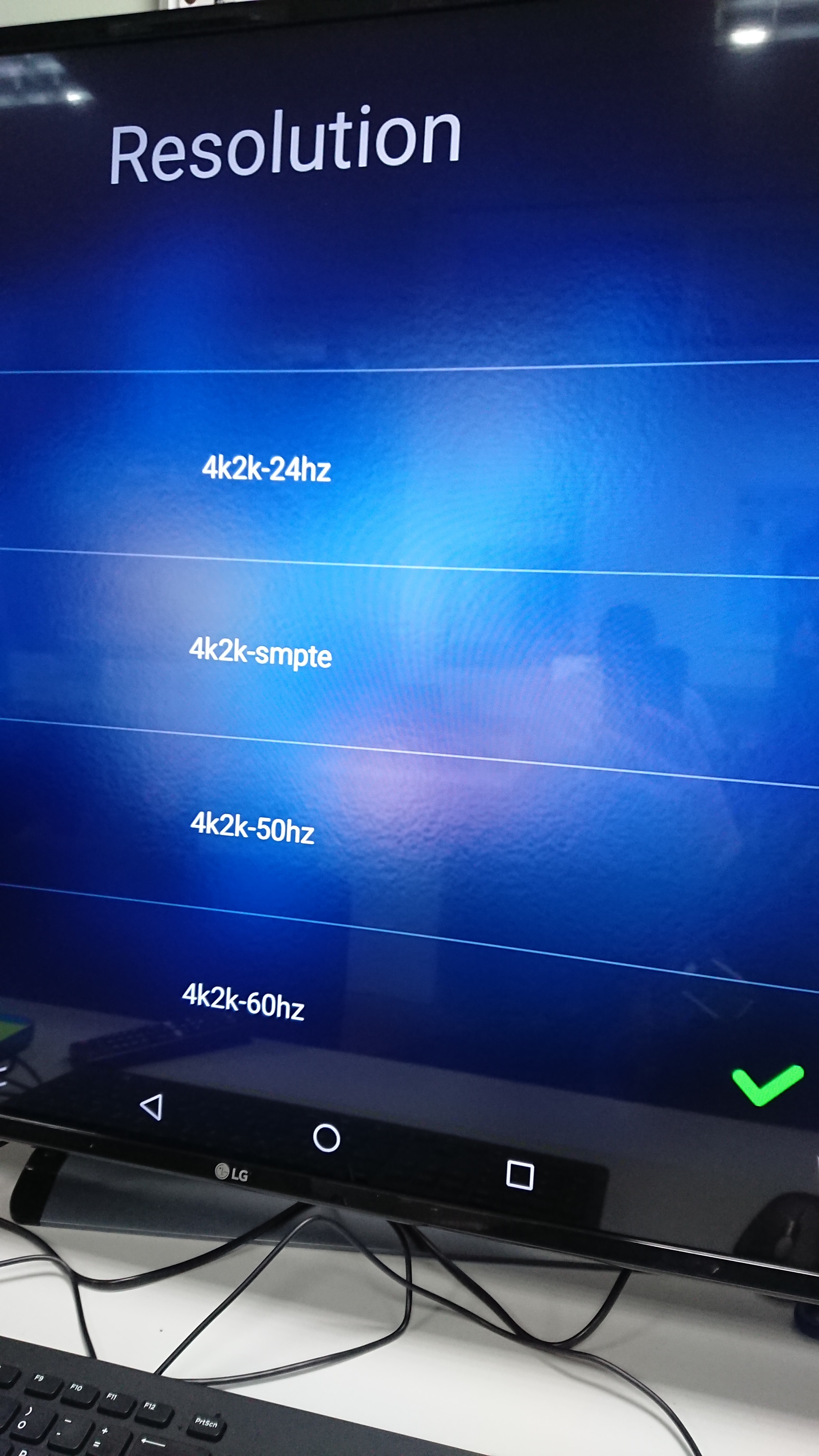

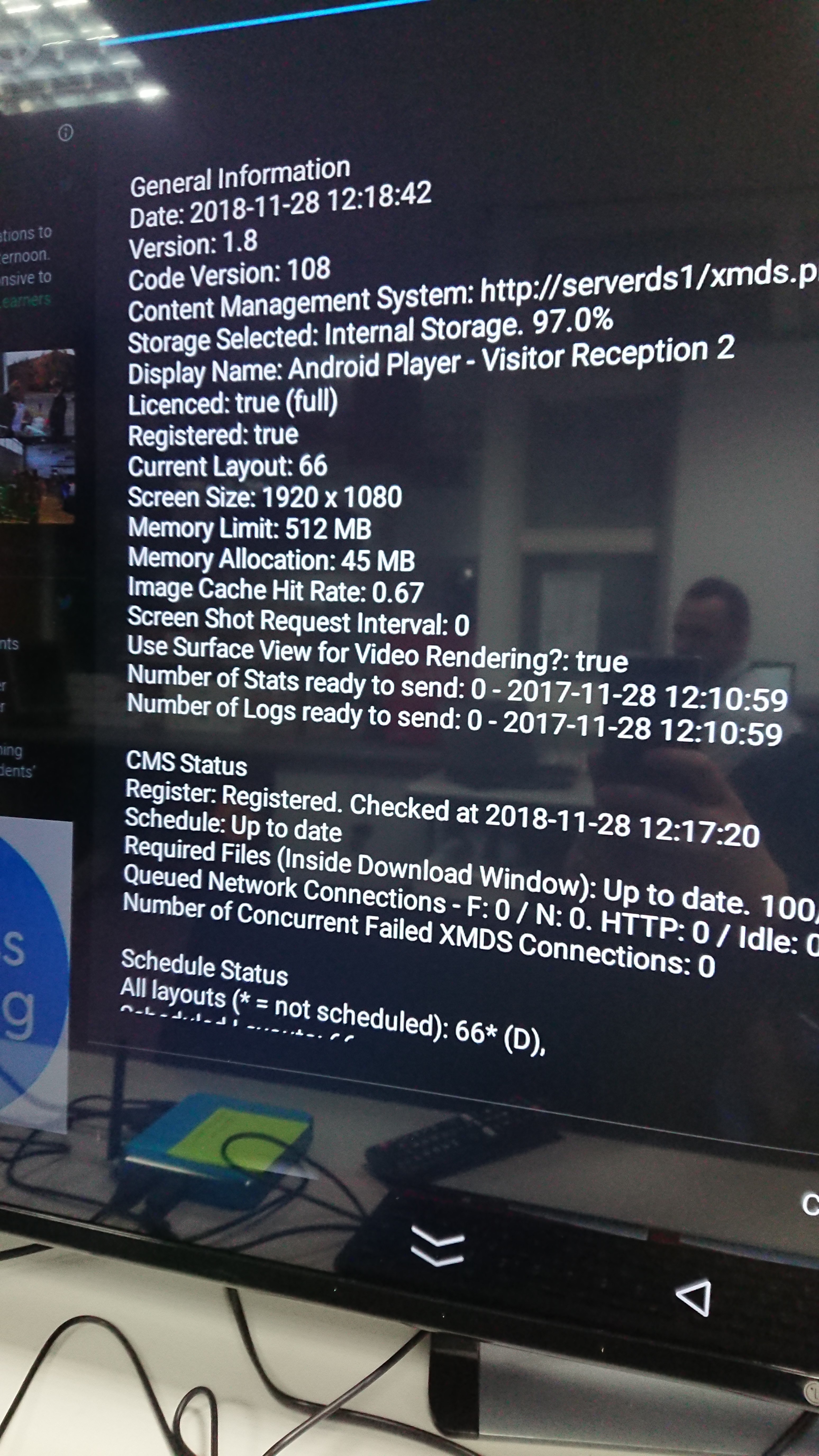

I’ve got an issue displaying a 4k layout whereas it will only show the Screen Size as 1920 x 1080 or when I manually enter the Screen Dimension on the profile, it will then go to 1920 x 1008. The Xibo player is set to 4k resolution in the settings.

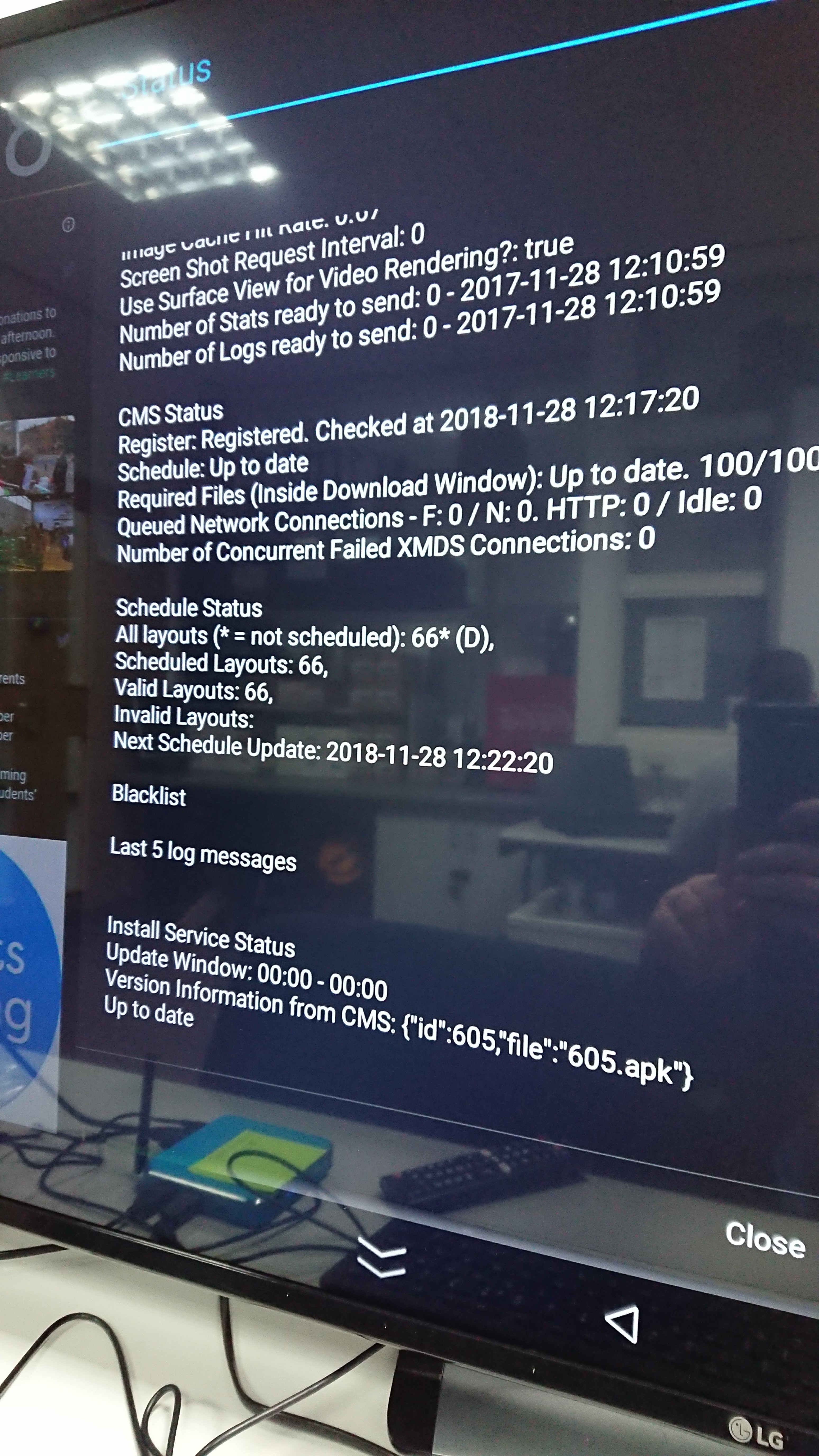

Some pictures of the settings and what not.
Thank you for the screenshots and further information. The reason you are experiencing this behaviour is due to the DSCS9 device and how 4K content is handled.
The DSCS9 runs at 1080p but is capable of outputting 4K content by upscaling 1080p. What this means is that when 4K content is scheduled to the device, it will be downscaled to 1080p, then upscaled to 4K and output to the screen. This is why you are seeing the 1080p resolution on your device.
