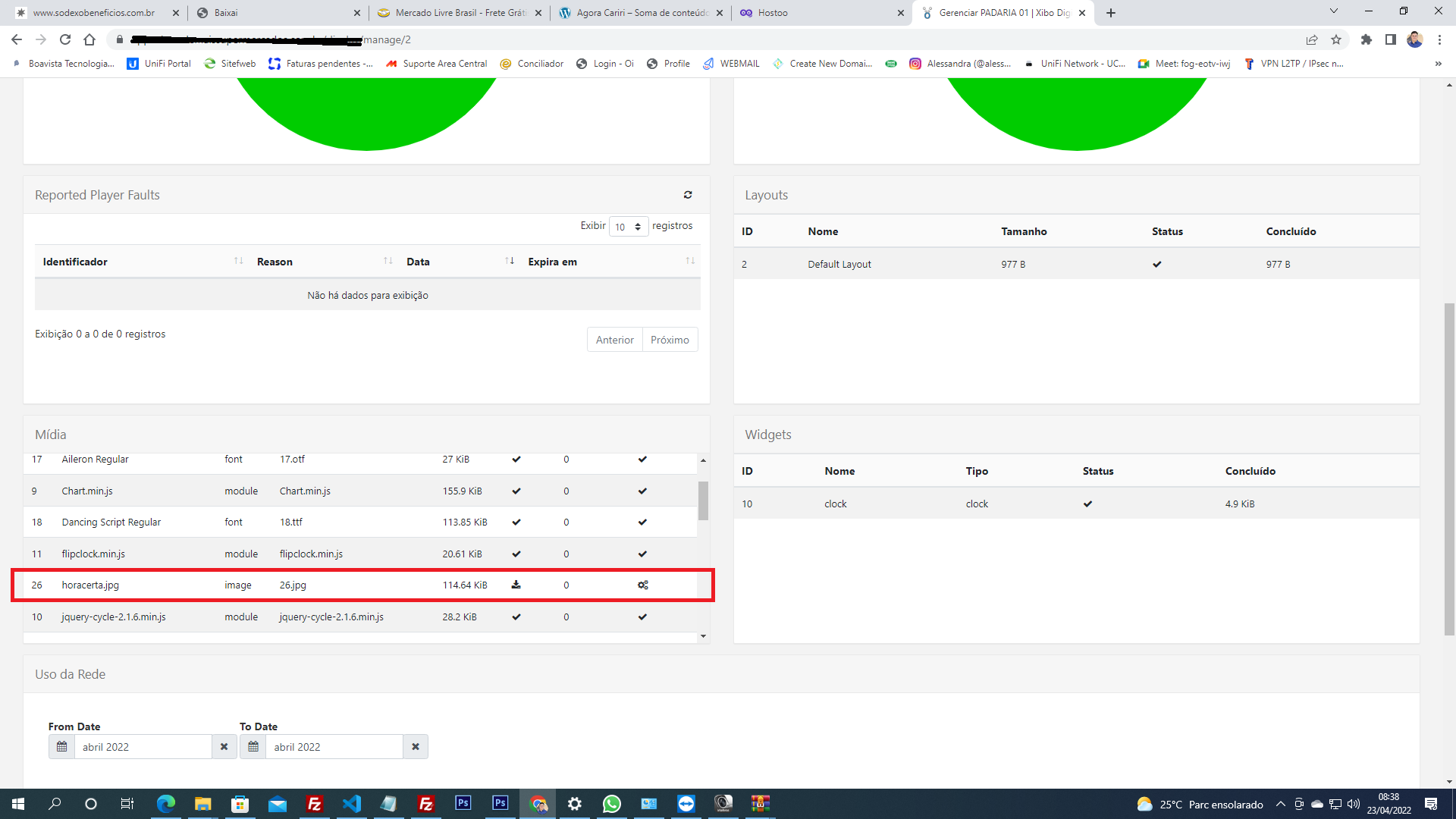

The first problem is encountered when we try to add a background to the Layout. Everything is added correctly and the layout is published without a problem. However, during the player update the background image is not loaded to the player leaving it in a loop.

@pitoco02 I did the steps but still having the same problem. The Client version is V3, I also tried it with V1.8, both with the same problem.

Check if this media exists in your “library” folder
Check if the database has the record of this media in the “Media” table
Try to remove this media from the platform, run the verification of ALL modules, and try to upload the image again.

how can i check the log page to send you. Already with version 3.1.0 it worked normally. I’m using PHP version 7.4.
Do you use the windows player, or android?
Have you checked the status tab on your player to see if there is an error?
