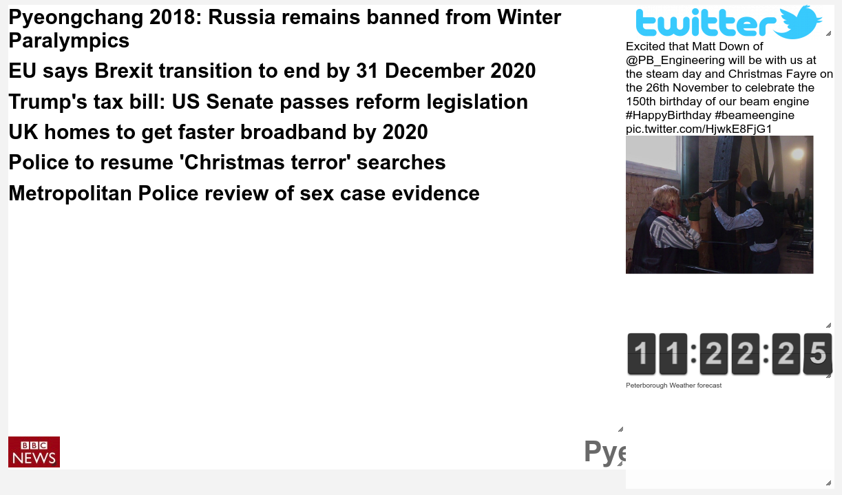

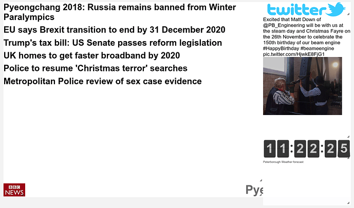

I updated from 8.2 to 8.3 yesterday using docker, since then I’ve had major issues with a widget that was working fine.
It’s simply a ticker cycling through 6 BBc news rss story’s.
Now it seems that ‘Number of items per page’ has no effect and it will simply display however many items is listed in ‘Number of items’, it then just sits there until it’s timer is up.
I’ve tried deleting the ticker and recreating. As well as playing with all the normal settings.
Can anyone help? I’m looking at going back to 1.8.2 as this has ruined the displays.
Thanks.

I’ve removed a few confidential slides but this still shows the error, I’ve made the ticker the first slide.
The behaviour shows in preview, design and on the Android screens.

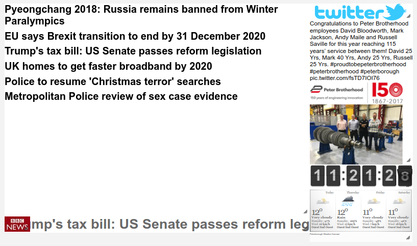

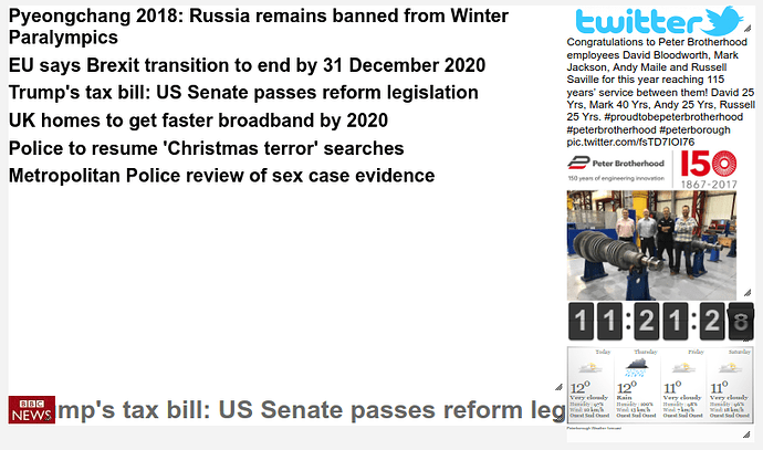

I’ve imported that on a 1.8.2 and 1.8.3 CMS and I see no difference to the BBC widget.
1.8.2:
1.8.3:

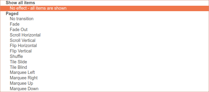

The number of items per page etc will only be respected when you have a transition effect set. You have it set to “None” currently. You’ll need to set that to “Fade” for example, and then only one item is shown at a time.
Wow, so simple when you know…
I changed that thinking ‘none’ would just flick from one to the next.
We will try to improve the way these options are presented to make it clearer:
May also be worth having a ‘no effect’ option to save CPU.
We will most likely go for something like this in that effect list:
