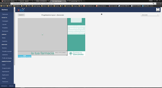

No the images dont’ show in preview if I set the full qualified path…

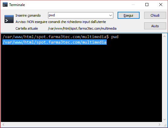

To get the correct path, from the server console, find the multimedia directory with your content in it and do pwd if it’s a Linux server to get the current working directory. The full path given is what you need to enter.
Ok my full path is /var/www/html/spot.farma3tec.com/multimedia

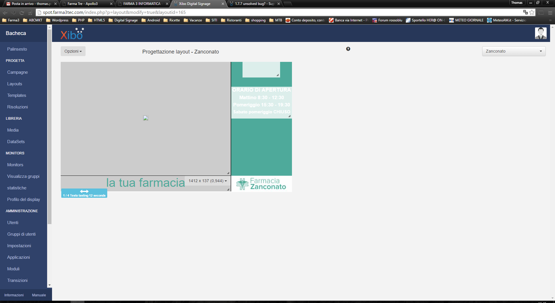

But I still see broken image in layout previews…
Probably the layout is invalid for this I see broken images

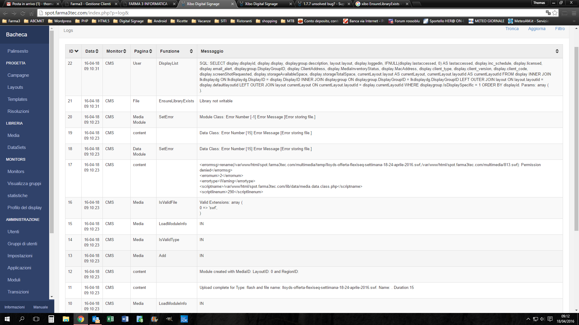

New problem, now when I can’t upload file…“Error storing file” when I try to upload. The fully path is correct. Why?

Library fully qualified path (/var/www/html/spot.farma3tec.com/multimedia), try to upload file, here is log:
The fully qualified path you should enter is:
/var/www/html/spot.farma3tec.com/multimedia/
You can’t just ommit the leading / character.
The permission denied message suggests that the permissions are still wrong on that directory. Please correct them. The whole library and all it’s sub directories need to be owned by the user your webserver runs as. So for Ubuntu you’d need to run:
chown -R www-data.www-data /var/www/html/spot.farma3tec.com/multimedia
I don’t know what user your webserver runs as so I can’t tell you the exact command to run.
