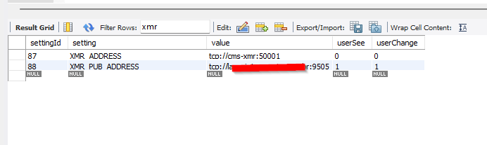

Please take a look at the settings table in your database. Check if the XMR ADDRESS address is correct there.
I appreciate the pointer but it checks out OK – has the right info there.
