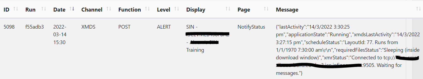

Anyone has any idea what the error I’m seeing below?
Should i be concern?
Hi Akram. The log you are seeing is a status log for a Xibo for Windows player. When you are using a Xibo for Windows player that log is generated when you request a screenshot from the player. If you go to the Displays menu in your CMS and click on the thumbnail for the requested screenshot you will see the same information listed underneath. This is what I see when I do that for my Windows player:
In short, there is nothing to be concerned about, this is a status log for the player, not an error.

Actually, its appearing in my logs every hour even tho if I did not request for a screenshot. Just suspected that it has something to do with the XMR not working correctly. I can see under displays “XMR Registered” column that its a tick and I do see XMR Status connected when i press “i”.

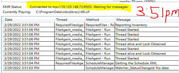

All is good here, hope you are well too. The fact that the log is being generated should not be an issue. According to the log your XMR service is connected and working.
A good way to test your XMR service is to request a screenshot from your player. If XMR is working your screenshot will be returned within seconds, definitely before the next collect interval. If it only returns on the collect interval then XMR is not working. You can also try the collect now button to see if the last accessed date updates when you do that.

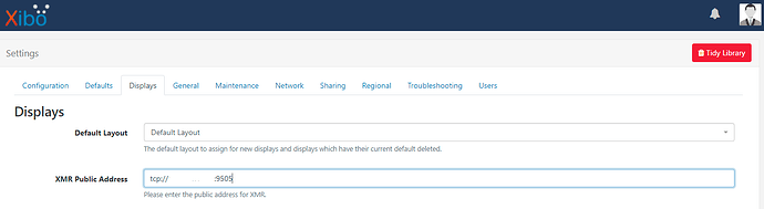

Thanks for your reply. Have you set the XMR public address correctly in your CMS? I can’t tell from your screenshot if you have entered the IP address or the domain name, please can you make sure to try just the IP address?
This was all I needed to do to get my XMR service working on my local installation. I have not used Openshift so I cannot confirm if your setup is somehow related to your XMR service not working. It is also very important that the time, date and time zone are correct on your CMS and player to within 30 seconds to ensure the messages do not time out.
Hi Dan, thanks for your reply too. Yes I have set the XMR public address, tried it with both the domain name and the IP address. The date and time on bothe the CMS and player are correct as well.

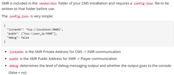

I did read up on the below regarding the config.json file. May i check in your installation is this file already existed or you have to create it?
Hello Dan, just wanna asked if you have an update on the following?
“I did read up on the below regarding the config.json file in the vendor/bin folder. May i check in your installation is this file already existed or you have to create it?”
Hi Akram, please excuse the delayed reply. Docker based installations should have XMR preinstalled, the config.json file is not necessary with that type if setup. Entering the tcp address into the XMR public address field in my previous screenshot should be enough to start the service.

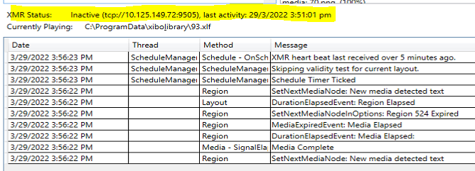

Your first screenshot suggests that XMR is running and waiting for messages. By default it uses port 9505, please can you make sure that port is open inbound for your CMS setup? You could also try an XMR reconfigure to see if this clears the issue you are seeing. To reconfigure XMR:

Hello Dan, noted on your reply. With this then its means that I do need the config.json file in the bin/vendor folder am i right? Thanks!
