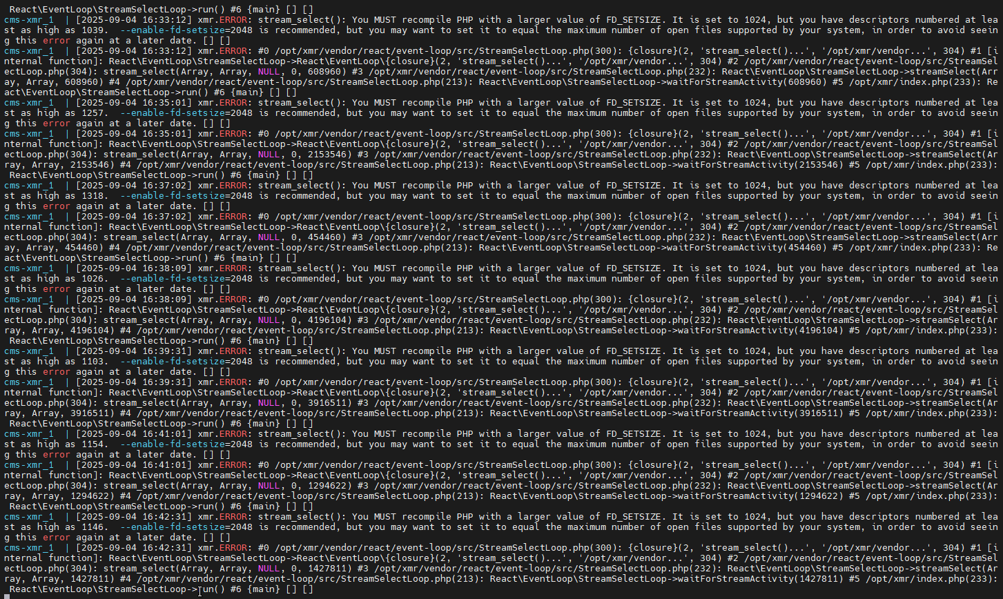

I’m getting this error in my XMR instance:
cms-xmr_1 | [2025-09-04 16:42:31] xmr.ERROR: stream_select(): You MUST recompile PHP with a larger value of FD_SETSIZE. It is set to 1024, but you have descriptors numbered at least as high as 1146. --enable-fd-setsize=2048 is recommended, but you may want to set it to equal the maximum number of open files supported by your system, in order to avoid seeing this error again at a later date.
cms-xmr_1 | [2025-09-04 16:42:31] xmr.ERROR: #0 /opt/xmr/vendor/react/event-loop/src/StreamSelectLoop.php(300): {closure}(2, ‘stream_select()…’, ‘/opt/xmr/vendor…’, 304) #1 [internal function]: React\EventLoop\StreamSelectLoop->React\EventLoop{closure}(2, ‘stream_select()…’, ‘/opt/xmr/vendor…’, 304) #2 /opt/xmr/vendor/react/event-loop/src/StreamSelectLoop.php(304): stream_select(Array, Array, NULL, 0, 1427811) #3 /opt/xmr/vendor/react/event-loop/src/StreamSelectLoop.php(232): React\EventLoop\StreamSelectLoop->streamSelect(Array, Array, 1427811) #4 /opt/xmr/vendor/react/event-loop/src/StreamSelectLoop.php(213): React\EventLoop\StreamSelectLoop->waitForStreamActivity(1427811) #5 /opt/xmr/index.php(233): React\EventLoop\StreamSelectLoop->run() #6 {main}
cms-xmr_1 | [2025-09-04 16:44:01] xmr.ERROR: stream_select(): You MUST recompile PHP with a larger value of FD_SETSIZE. It is set to 1024, but you have descriptors numbered at least as high as 1152. --enable-fd-setsize=2048 is recommended, but you may want to set it to equal the maximum number of open files supported by your system, in order to avoid seeing this error again at a later date.
cms-xmr_1 | [2025-09-04 16:44:01] xmr.ERROR: #0 /opt/xmr/vendor/react/event-loop/src/StreamSelectLoop.php(300): {closure}(2, ‘stream_select()…’, ‘/opt/xmr/vendor…’, 304) #1 [internal function]: React\EventLoop\StreamSelectLoop->React\EventLoop{closure}(2, ‘stream_select()…’, ‘/opt/xmr/vendor…’, 304) #2 /opt/xmr/vendor/react/event-loop/src/StreamSelectLoop.php(304): stream_select(Array, Array, NULL, 0, 716003) #3 /opt/xmr/vendor/react/event-loop/src/StreamSelectLoop.php(232): React\EventLoop\StreamSelectLoop->streamSelect(Array, Array, 716003) #4 /opt/xmr/vendor/react/event-loop/src/StreamSelectLoop.php(213): React\EventLoop\StreamSelectLoop->waitForStreamActivity(716003) #5 /opt/xmr/index.php(233): React\EventLoop\StreamSelectLoop->run() #6 {main}
just restarted my XMR container, and still persist.
What can it be?
Thanks!

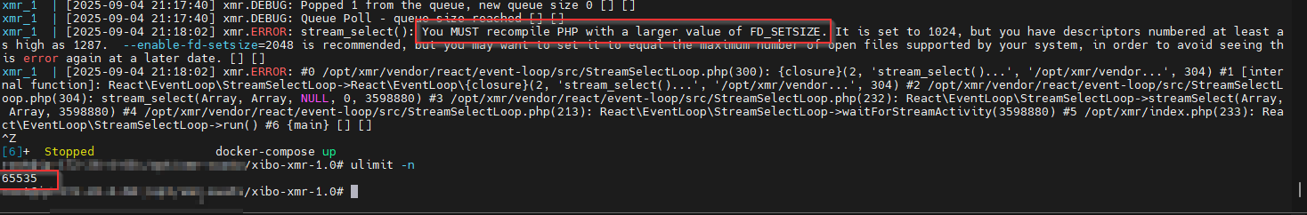

My ulimits are high:
I guess you are on docker-compose, are you refering to host ulimits and not container ulimits ?
