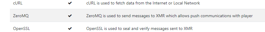

  • ZMQ PHP is registered and confirmed working
  • when installing Xibo CMS i get all ticks on the pre-installation page

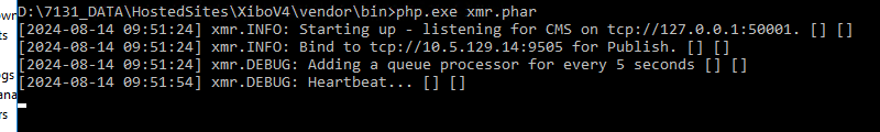

  • have XMR running in CMD window with Hearbeats every 5 seconds by no activity

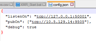

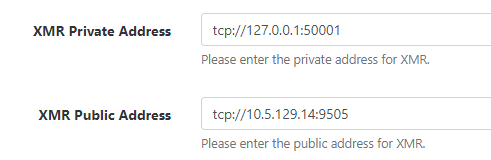

  • settings for Public and Private addresses setup in CMS

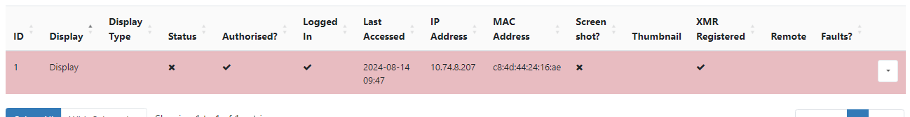

  • have successfully added a display, it downloads content but only displays the Xibo Splashscreen.
display just states its still downloading content but it has downloaded all files required for the layout assigned to it.

display Screen:

but still no communication messages through the XMR window while its running.
