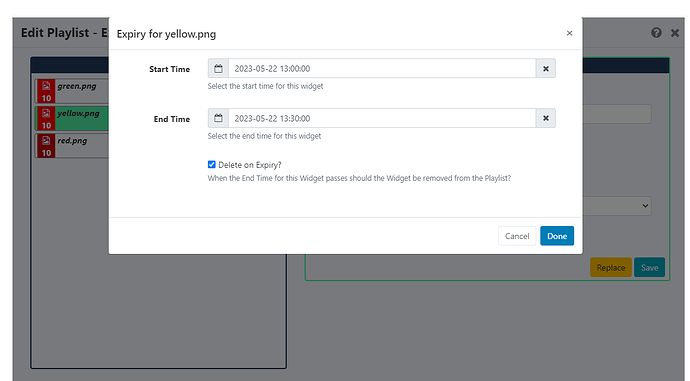

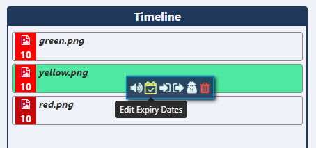

I went to the Playlist page in my CMS, created a playlist and added some media items. On one of the items I set it to expire by right clicking on the item and choosing the expiration option from the mini menu that appears. I set a start and end date/time and ticked the Delete on Expiry box:

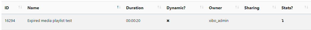

I could also see that the playlist had a note to confirm that it will update its duration at the time I set that media to expire:

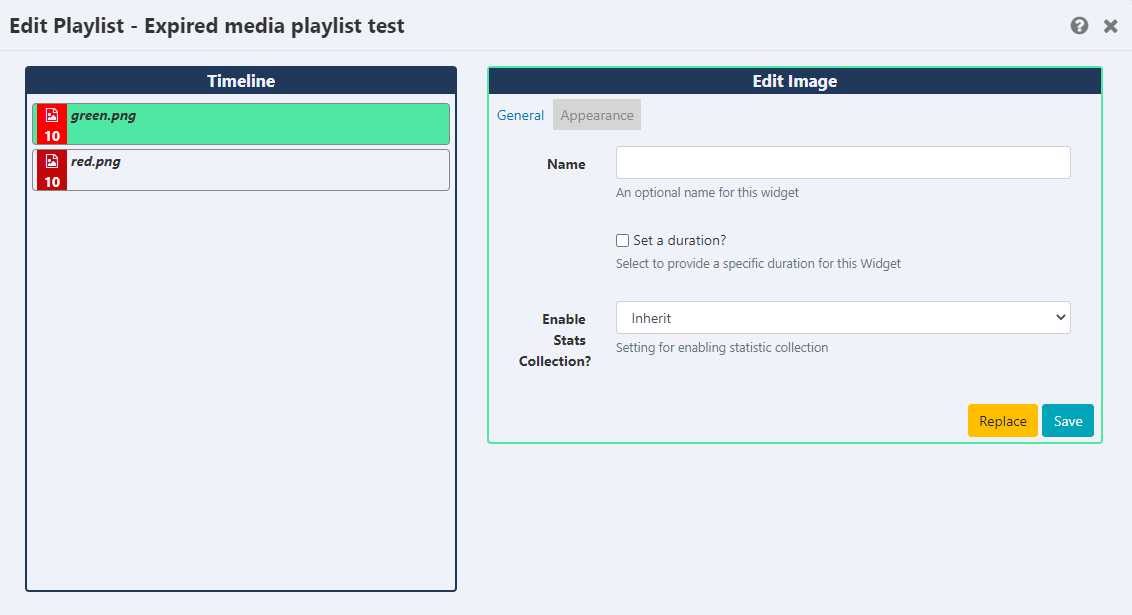

I waited until 13:30 and checked the Playlist. The duration was in the process of updating. The Regular maintenance task, which is responsible for updating playlist durations was still running, so I waited for it to finish. Once the duration was updated, I checked the playlist and the media item was gone:

  • Did you set the expiry for the media item by right clicking on it and choosing the Edit Expiry Dates option as I described?
