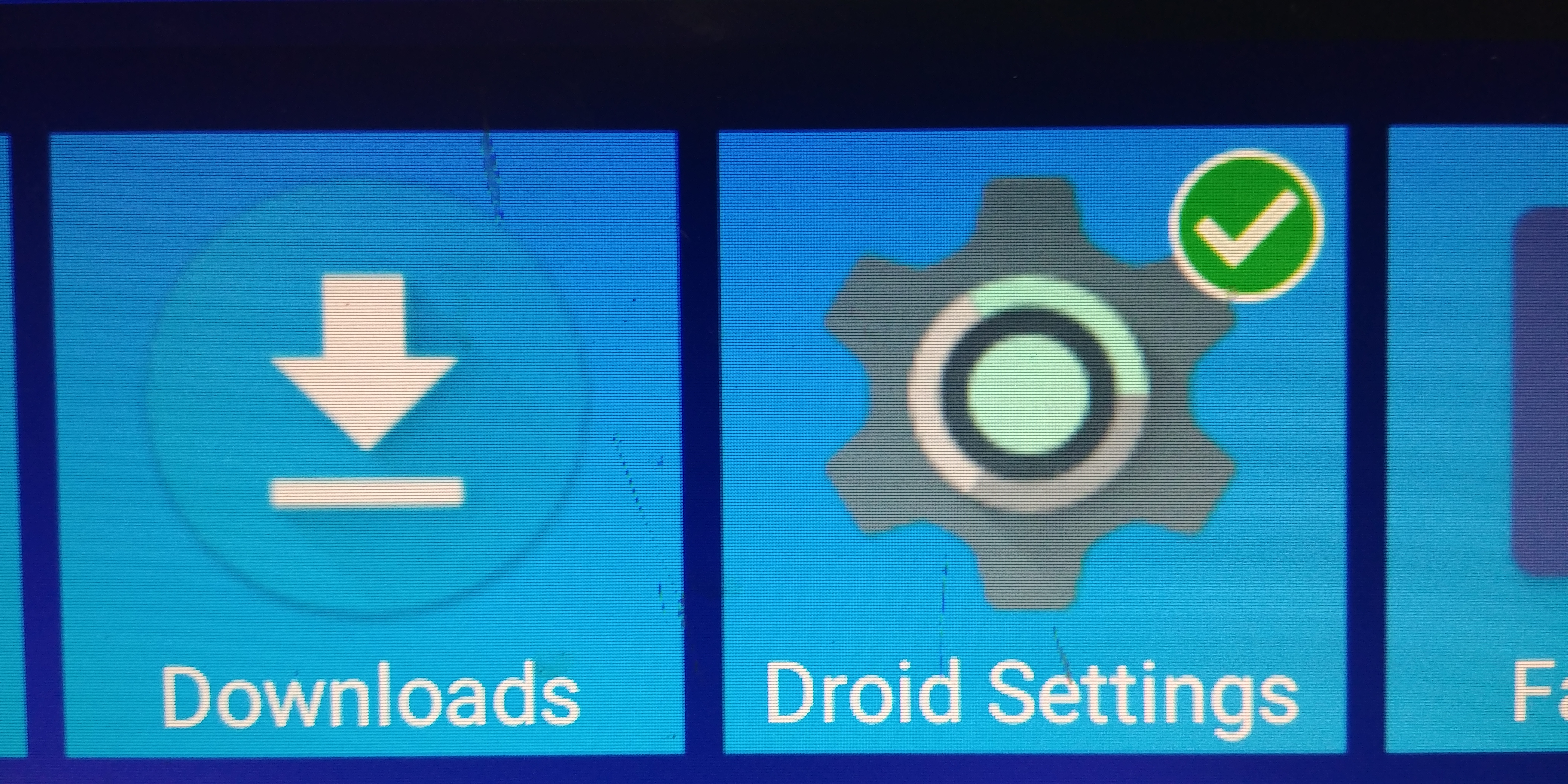

on our Shuttle NS02A devices, you go to Settings/Display/Screen Scale.
maybe that is not a native Android feature.
maybe reach out to the device manufacturer. (what devices are you using?) Edit, nevermind, just realized I had replied to another one of your posts and you mentioned the devices. that is very similar to my test device that does not have the scaling option…
nevermind again! just found the settings.
see the pictures I’ve attached. see if your setup is similar.
need to go to “Droid Settings” in my case, not the regular “Settings”
I found the droid settings. It is set to 100%. It is really strange because i have my own test stick at home on a 55" LG TV, that looks perfect.
