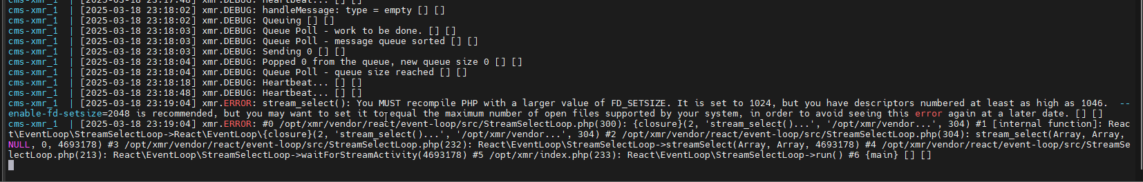

cms-xmr_1  | [2025-03-18 23:19:04] xmr.ERROR: #0 /opt/xmr/vendor/react/event-loop/src/StreamSelectLoop.php(300): {closure}(2, 'stream_select()...', '/opt/xmr/vendor...', 304) #1 [internal function]: React\EventLoop\StreamSelectLoop->React\EventLoop\{closure}(2, 'stream_select()...', '/opt/xmr/vendor...', 304) #2 /opt/xmr/vendor/react/event-loop/src/StreamSelectLoop.php(304): stream_select(Array, Array, NULL, 0, 4693178) #3 /opt/xmr/vendor/react/event-loop/src/StreamSelectLoop.php(232): React\EventLoop\StreamSelectLoop->streamSelect(Array, Array, 4693178) #4 /opt/xmr/vendor/react/event-loop/src/StreamSelectLoop.php(213): React\EventLoop\StreamSelectLoop->waitForStreamActivity(4693178) #5 /opt/xmr/index.php(233): React\EventLoop\StreamSelectLoop->run() #6 {main} [] []
It runs well for like, 4 minutes,
Commands are running fine, screenshots etc.
And then it crash with this error;
obs: I’ts a machine (ubuntu) running only XMR for more than one CMS:

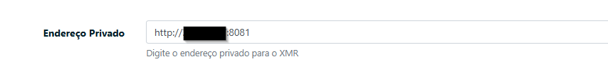

And my CMS:
As you can see, all well setted.
Update:
Apparently, even with the error, XMR continues to work normally.
Strange.
The debugger shows the error, then an “exited”
However, the commands continue to work normally.

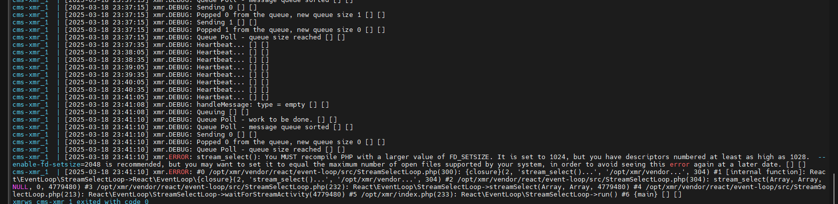

cms-xmr_1  | [2025-03-18 23:41:10] xmr.DEBUG: Queue Poll - queue size reached [] []
cms-xmr_1  | [2025-03-18 23:41:10] xmr.ERROR: stream_select(): You MUST recompile PHP with a larger value of FD_SETSIZE. It is set to 1024, but you have descriptors numbered at least as high as 1028.  --enable-fd-setsize=2048 is recommended, but you may want to set it to equal the maximum number of open files supported by your system, in order to avoid seeing this error again at a later date. [] []
cms-xmr_1  | [2025-03-18 23:41:10] xmr.ERROR: #0 /opt/xmr/vendor/react/event-loop/src/StreamSelectLoop.php(300): {closure}(2, 'stream_select()...', '/opt/xmr/vendor...', 304) #1 [internal function]: React\EventLoop\StreamSelectLoop->React\EventLoop\{closure}(2, 'stream_select()...', '/opt/xmr/vendor...', 304) #2 /opt/xmr/vendor/react/event-loop/src/StreamSelectLoop.php(304): stream_select(Array, Array, NULL, 0, 4779480) #3 /opt/xmr/vendor/react/event-loop/src/StreamSelectLoop.php(232): React\EventLoop\StreamSelectLoop->streamSelect(Array, Array, 4779480) #4 /opt/xmr/vendor/react/event-loop/src/StreamSelectLoop.php(213): React\EventLoop\StreamSelectLoop->waitForStreamActivity(4779480) #5 /opt/xmr/index.php(233): React\EventLoop\StreamSelectLoop->run() #6 {main} [] []
xmrws_cms-xmr_1 exited with code 0
Screenshot/NotifyStatus Running:
That’s interesting; I presume its because of the number of displays you have connecting. When the service exits it will restart, so I guess that is why you see it still working. It’s probably exiting and restarting over and over?

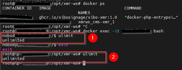

I don’t know whether this could be on the host machine perhaps? If I run ulimit on both the container and the host I get unlimited out; what do you get?
i got unlimited in both HOST and XMR 1.0 container:
1- Container
2 - Host
And it seems to be an error related to the container’s PHP.
I don’t even have PHP installed on the host… everything is inside the container itself.
