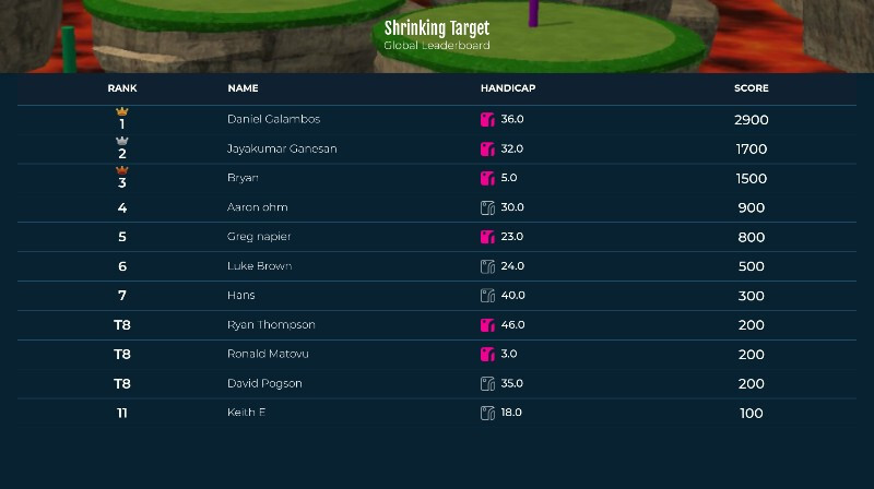

I added your webpage URL to a test layout (using a webpage widget, set Options to open natively) and it displays without issue at the moment. Here is a screenshot from my player:
I’m using Xibo for Android R311 on my DSCS9X, which is running Android 9 and using Webview version 99.
