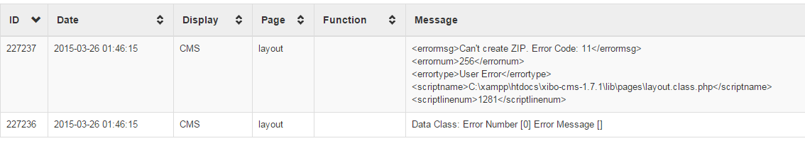

this is the log for the error message…

There won’t be a file because we can’t create it!

The CMS creates the ZIP file for export in the temp folder of the library. If your layout was called bob
and your library location was c:\xibo\library
then it would be trying to create c:\xibo\library\temp\export_bob.zip
Change ZipArchive::OVERWRITE to ZipArchive::CREATE.
From this link http://php.net/manual/en/ziparchive.open.php#110651
Or just upgrade to 1.7.4 where this is already fixed.
