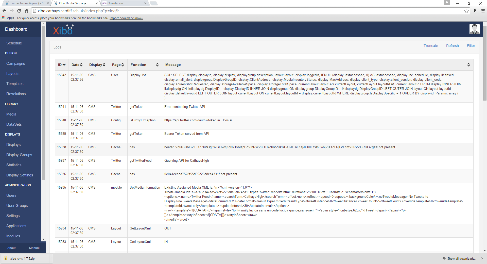

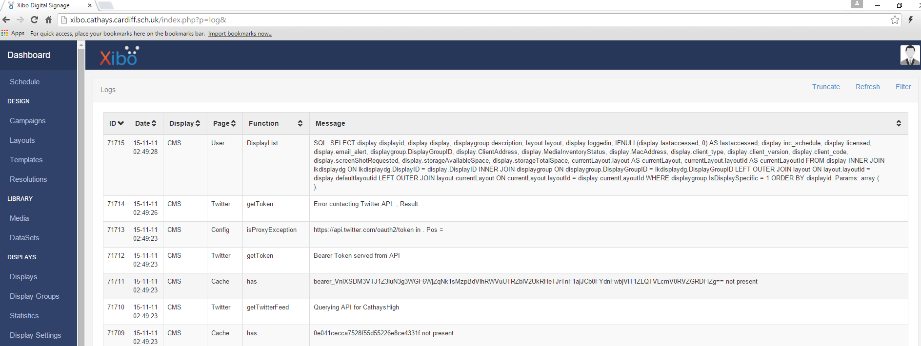

Twitter has decided to stop working! We had it going for a couple of days and now nothing! Logs Below:
14006 15-11-06 08:43:42 CMS Twitter getToken Error contacting Twitter API:
14005 15-11-06 08:43:42 CMS Config isProxyException https://api.twitter.com/oauth2/token in . Pos =
14004 15-11-06 08:43:42 CMS module SetMediaInformation Existing Assigned Media XML is: \n <?xml version="1.0"?>
14003 15-11-06 08:43:42 CMS Layout GetLayoutXml OUT
14002 15-11-06 08:43:42 CMS Twitter getToken Bearer Token served from API
14001 15-11-06 08:43:42 CMS Layout GetLayoutXml IN
14000 15-11-06 08:43:42 CMS Cache has bearer_VnlXSDM3VTJ1Z3luN3g3WGF6WjZqNk1sMzpBdVlhRWVuUTRZblV2UkRHeTJrTnF1ajJCb0FYdnFwbjViT1ZLQTVLcmV0RVZGRDFiZg== not present
13999 15-11-06 08:43:42 CMS module Module created with MediaID: 81 LayoutID: 9 and RegionID: 587056377aadea7c5
13998 15-11-06 08:43:42 CMS Twitter getTwitterFeed Querying API for CathaysHigh
