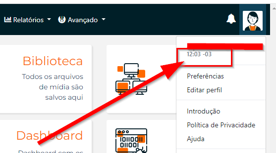

The way that a quickly check the CMS time is by clicking on the avatar and checking the time:
if it’s wrong, maybe it is good to check the timezone in your “phi.ini” file.

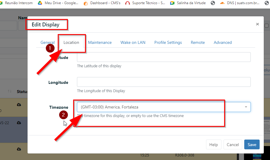

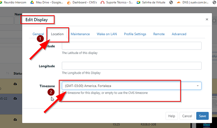

In addition to checking the timezone directly on the device, also verify the timezone in the display settings directly through the CMS.
In your case, as you said that you are from Spain, i recommend that you research the specific time zone of your location and configure the items I mentioned above accordingly. Let us know here if it worked.
