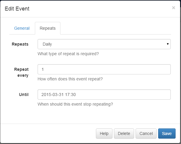

That shows you that there’s a recurring schedule on those days. Clicking on any one of those symbols will open your ORIGINAL schedule form, showing the first time the event happened and the repeat setup. It won’t be different for each day, but the event will apply on each day as the symbol shows.

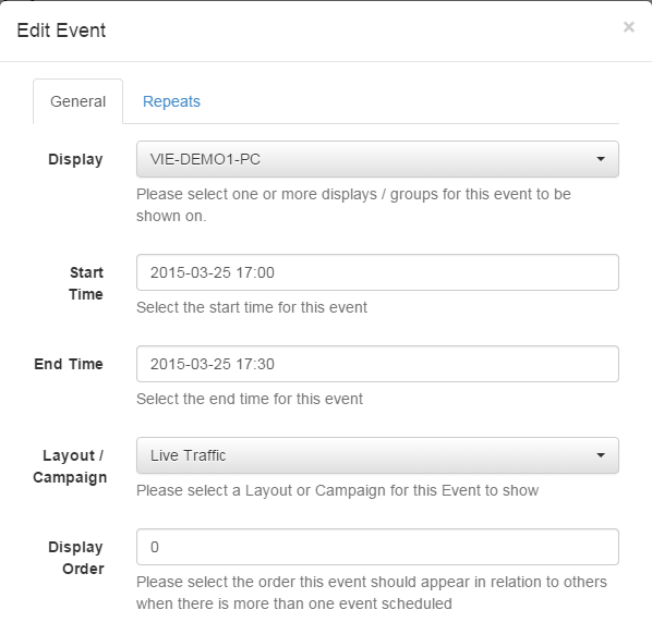

i want to plan a campaign every Monday for example, i put the same parameter to Tang excepted for repeats where i put weekly but when you show monthly view events appear in all day .
Can you check that the times your getting on the schedule are the ones you’re clicking. We’re investigating an issue where the date entered isn’t the one you chose:
I just recently ran into a need to display content every 15 minutes on all of my displays. I set the layout containing the content to repeat every 15 minutes for a month. The results are tons of the repeat signs (96), one for each repeat on a day. Is this correct? I scheduled it for 12 displays for a month each. This has made the scheduling user interface quite slow. Just looking for a bit of feedback to see if that is correct. I was expecting to see one repeat sign on each day to show that the layout was set to repeat.

The key is that your initial schedule should be for the first instance of the layout running only, and then subsequent ones are handled by the Repeat tab.
What alot of people do is try and schedule the whole time they want the layout to run, and then have it repeat, which gives you multiple duplicate schedules all starting at the repeat interval (and that’s exactly what happened above).
