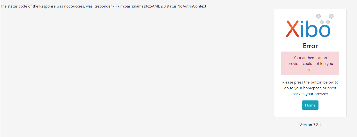

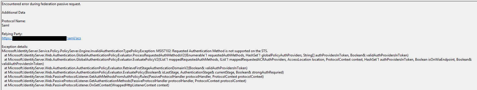

Error message from ADFS:
Error message from xibo (when Form Authentication is not enabled):

Hi, welcome to the Community!
Try adding the following inside the security array inside $advancedSettings in settings-custom.php/settings.php
'requestedAuthnContext' => false,
So you would have something like this, but with the values you want to set:
