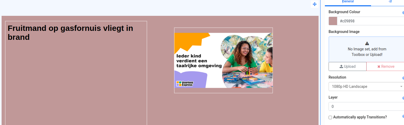

Hi Johan,
The RSS feed is working on CMS version 4.2.1. Could you please check on your end?
We believe that something may have changed in the RSS feed itself, making it incompatible with your CMS. This was never an issue on the CMS side.
Hello Israt,
The way you use it, it would work, but that is not wat e want to use. You can check it on our stream (on the site).
We use the RSS feed from 3.x to do wat whe want (or need).
