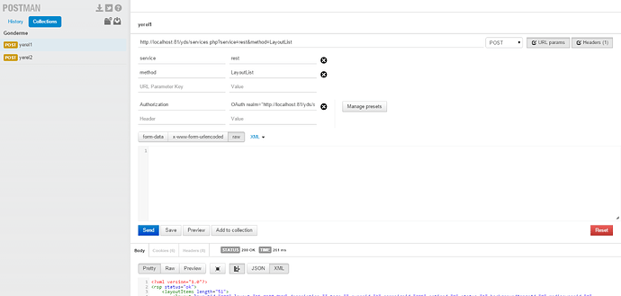

Lets forget about .net and simulate this from Postman app (which is chrome extension, and test api calls)
I am not sure which format should I use.

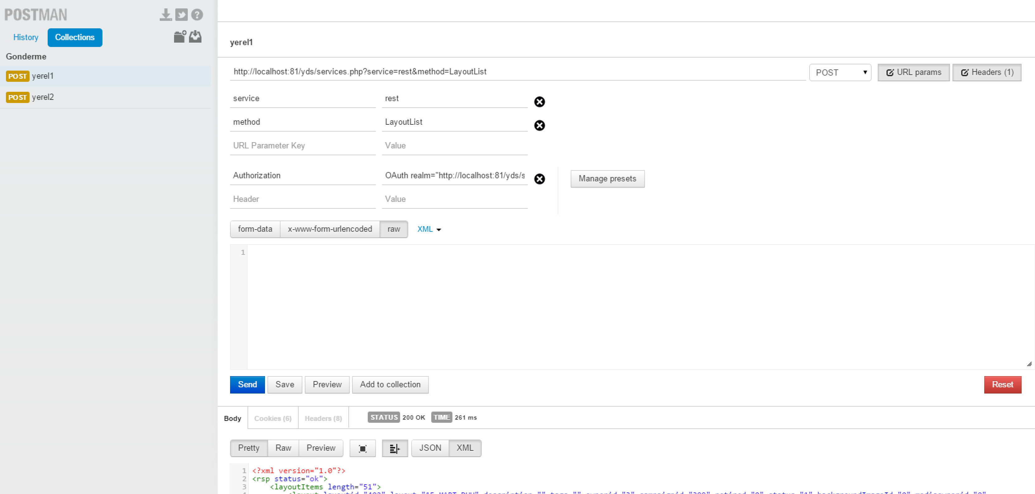

This screen shot shows; if you write all parameters to querystring it works.I can use querysting but as you know it has character limit, so I have lots of media to add so querystring is not usable if you send lots of data.

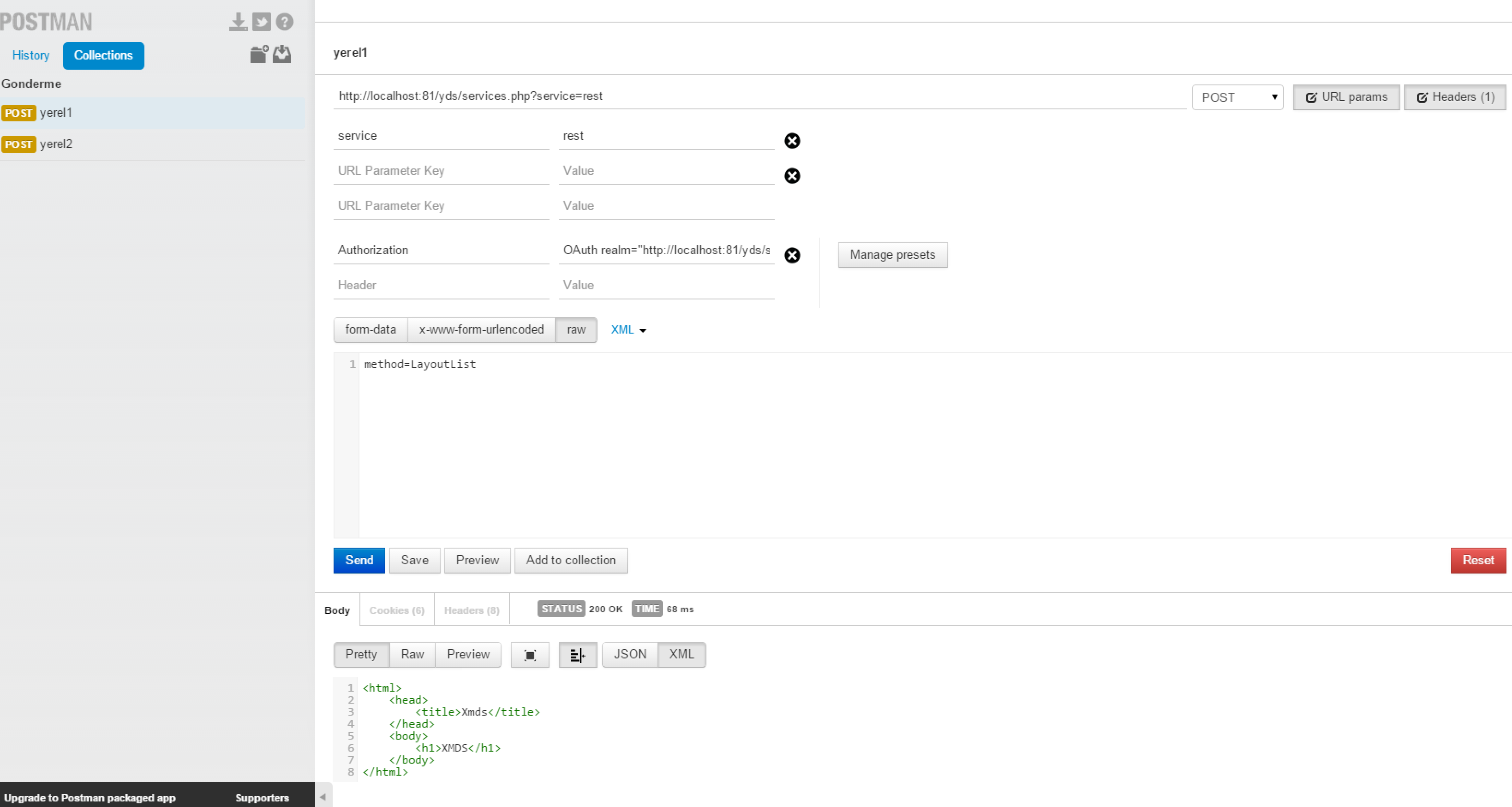

But if you use body, as screen shot, it always return “XMDS” (same as you write the services.php url without any parameter, it never reads paramater from body)
I try to change content type to xml,json,text, Try to change data format to xml, json, text. Nothing help.

All you do is put the query string in the body and then post - please see my last message which explains that
