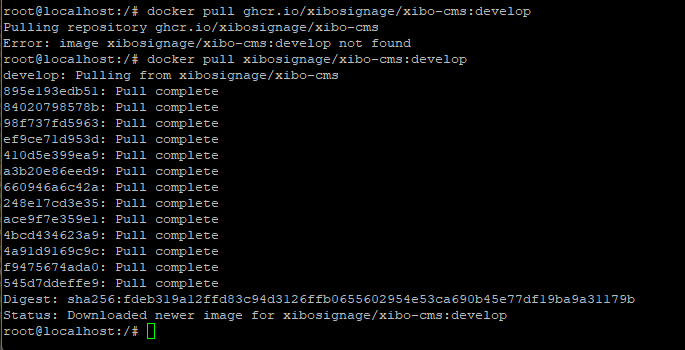

I’m really not sure, as Alex suggested a few comments back, its almost like there is something between you and it that has cached the state of the registry.
I get a ping reply from the same IP as you though when I ping it.
We push into develop very regularly as we’re working, so this image is always being pushed and pulled:
docker pull ghcr.io/xibosignage/xibo-cms:develop
I’m sorry, this is so strange!
when pull the developer Version without “ghcr.io/” it works
That will be an old image from Dockerhub.
I’m sorry, but I can’t explain it.
