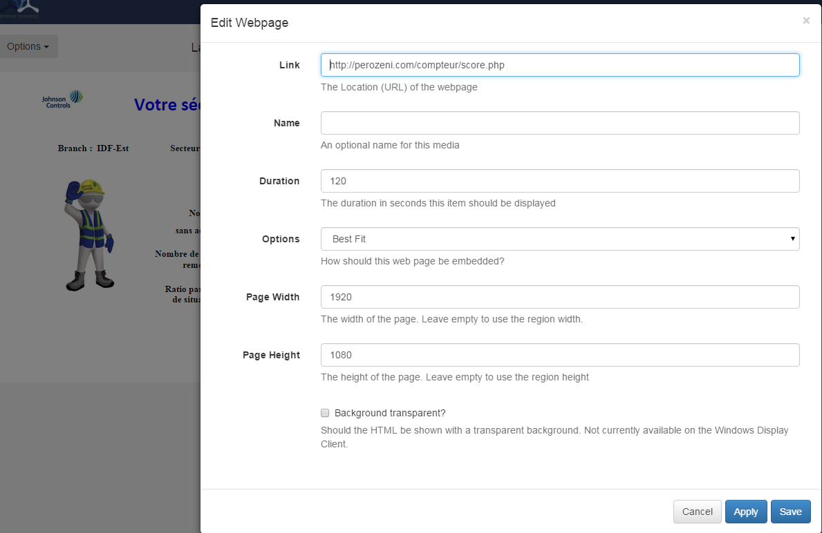

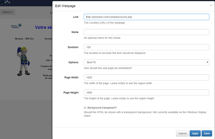

I tried everything possible. Enable double buffering or not, CEF web browse or not, manual position, Open natively, Best fit. Different scale percentage, background tranparent. Nothing can be done.
As the page blocks on the picture, could it be the type of the image who is involved ? It’s a JPG picture. I’m going to try to change de picture.
With all the realized tests, I observed that what displays on xibo player is a square about 50x50 pixels in which appears my webpage of 1795 x1080. This is why I only see the upper left of the page. Nothing to see with the picture in the webpage.
This square can be seen in the CMS too, when I save the Edit of the WebPage. IE, when I click on Apply, during half a second, I can see this square (yes, in the CMS !!), Then, the web page appears above. What is not made on the display.
