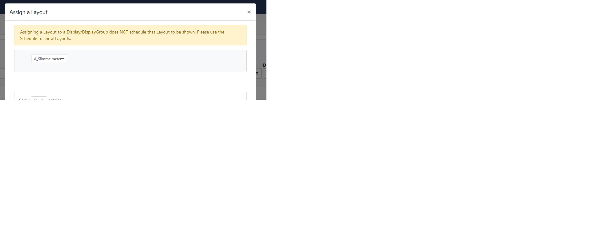

I have assigned the layout to the player, like described here.
Also, I added the layout to the schedule. But the preload doesn’t seem te be working.

As a side note, you do not need to also assign this Layout to a Player. It can be set to preload (if supported by the Player) and scheduled.
