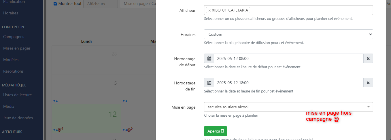

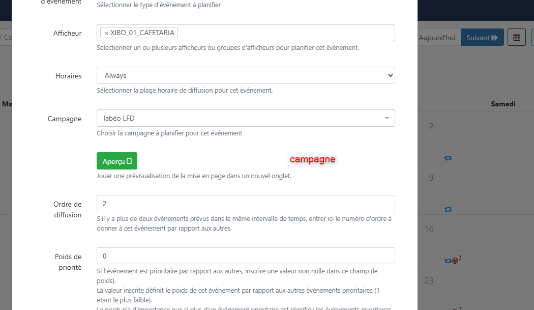

Je programme une campagne sur toujours et une mise en page avec une date custom.
Malgré que j’indique un poids, la mise en page ne s’affiche pas
Celle ci ne s’affiche uniquement si elle est dans la campagne.
Nous pouvons pas mettre 2 publications en mm temps?
En vous remerciant d’avance de votre aide
Si je mets mes mises en page uniquement en “custom”, je me retrouve avec un écran noir de xibo avec le logo. je pense donc que la planification custom ne fonctionne pas .
Hello, yes you can schedule multiple Layouts and Campaigns to show at the same time. Firstly I can see from your screenshot that you have some priority scheduling. Anything with the highest priority will be the only thing that is shown, anything with a lower or no priority will be omitted from the schedule for its set times. So I would take a closer look to see what has been set with a priority and remove those (if they should not be the only thing showing) to see if that resolves your issue as a first step.
What are you wanting to achieve? A Campaign that is always showing and a Layout that is only shown between the hours of 08:00 - 18:00? What is the duration of the Layout? Should the Layout be the only thing to be shown during this time or should other content (Layouts within the Campaign) also be shown in fair rotation? Why have you set a display order for the Campaign?

Hello
Thank you for your reponse.
That’s what I thought I read in the documentation, but it doesn’t work.
I thought I had to set priorities, and then it would display based on the number, meaning the highest number would start and then it would go from highest to lowest.
I have four different scheduling options (they’re in the “Schedule” tab).
If I select “Custom,” which is the most appropriate if I only want it to display for 24 hours or 1 month, I get a black screen with the logo in the bottom right corner (I think the custom setting isn’t working).
I waited 10 minutes in front of the screen.
If I select “Always,” the schedule appears on the TV after about 5 minutes.
Indeed, I want my campaign to display 24 hours a day, and then the additional layouts, I only want them on certain dates, some for 24 hours and others for 1 month. So, one campaign from 8 a.m. to 6 p.m. every day throughout the year. A layout about road safety will be displayed for one day from 8 a.m. to 6 p.m., which I’d like to plan in advance so I don’t have to put it up on the day of the campaign (a different layout for each day). Another layout about computer security will be displayed for one month, with the layout changing approximately every 15th of each month.
If custom doesn’t work, is it a setting in xibo? Maybe the device isn’t set to the same time as the software, or maybe the custom setting is incorrectly programmed?
Do you have any solutions I could look into?
Thank you for your help.
The question is do you want these to all play in fair rotation, so your Campaign, Road Safety Layout and Computer Security Layout are all shown each day, or do you want just one thing to be the only thing shown on a particular day?
I think you might want something like this:
Campaign: Custom 8am - 6pm, 0 Priority, Repeat Weekly (set all days it should be shown on)
Road Safety Layout: 8am - 6pm, 1 Priority if the only thing to be shown. If it’s to be shown in rotation with the Campaign other Layouts then keep at 0. Repeat Weekly (set the day it should be shown on)
Repeat the above to select the different Layouts that need to be shown for different days.
- Computer Security Layout: Always or Custom 8am - 6pm, 0 Priority, Repeat Weekly (set all days it should be shown) set the until date as the 15 of the next month.
