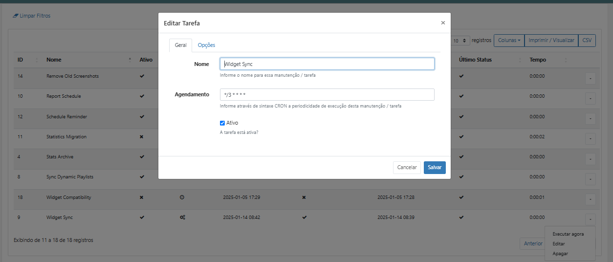

Is XTR and the Widget Sync task running in your CMS installation? Data is kept up to date in the background via XTR, if it isn’t running then you won’t see any updates.
It’s like this:
My installation was done using Docker, so from what I understand I wouldn’t need to create a routine on my server to run xtr as one would already be configured?

Hi @Henrique_Lucas,
I’ll assume you’re testing this in a local environment. If so, CMS tasks like the Widget Sync task don’t run automatically. To trigger it, while your Layout is scheduled to the Player, run:
clear && docker-compose exec web /bin/bash -c "cd /var/www/cms; LOG_TO_CONSOLE=true php bin/run.php 9"
This runs the designated task and prints the logs to the console.
Replace 9 with the actual Task ID from your CMS.
If you prefer to run it without console logging:
clear && docker-compose exec web /bin/bash -c "cd /var/www/cms; php bin/run.php 9"
Change web to match the name of the container you are using.
The reason it is not working on your local setup is that the CMS is responsible for refreshing the data and passing it on to the Player, and this is done by the Widget Sync task. On a production system this task runs automatically, but in a local setup it usually does not run unless you start it yourself. That is why you do not see updates until you intervene. Running the command above simply forces the Widget Sync task to run so the Player can receive the updated data.

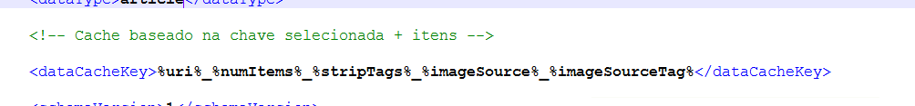

I think I found one of the problems.
This “dataCacheKey” class from my custom module only had the “uri” key.
I copied it as it was from the original module with more tags, and it seems to have worked.
It ended up like this:
