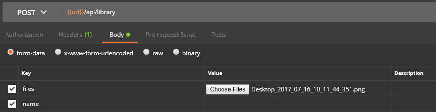

You will need to pass the ‘name’ parameter as well in your call.
If you leave it empty (as per screenshot below) media name in CMS will be the same as the source file from the hard drive.
If you pass any value in the name parameter then that will be the media name in the CMS.
Side note, we’ve made some changes with how the upload via API is handled, in the next release, you will be able to simply not pass the ‘name’ parameter and it will upload it fine with the original fileName to the CMS.

Could you give me a screenshot from postman showing you call please?
Does the ‘files’ parameter is set to ‘file’ type like in my screenshot?
Also I realized that I didn’t ask, it is 1.8.2 CMS version, correct?
