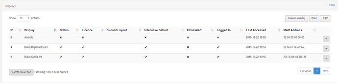

I am wondering if I did that as you wanted? :neutral_face:
Screenshot of Displays screen:
You did exactly as I wanted, but unfortunately there isn’t enough logging in there :frowning:
