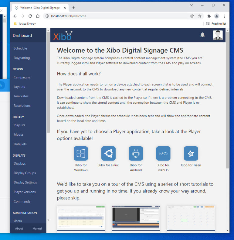

Hi Natasha,
Thank you again for such prompt reply. Correct, that’s exactly the guide used for my test. Let me share some info, to provide some context:
If I load the Xibo container with Docker using the default configuration (ports 80:80 in the docker-compose config file), I get the errors on the images 1 & 2, and cms-web won’t run (image 3).
I updated the ports used by the docker-compose config file, using the ports 8080:8080. Once I update this specific information, all errors go away and Xibo docker seems to be up and running (image 4), but every time I try to load the login screen to access the dashboard, I get the error shown on image 5.
If I check the logs for the cms-web, it just stops at the “starting webserver” step (image 6).
A bit difficult to identify the reason for not loading, since I don’t see any visible error messages (or container not running).
The container is still running on port 80. If you want to map it to a different port you would need to use 8080:80 and not 8080:8080.
The ports section of a Docker Compose YML file lists ports in the format <host>:<container> - to move to port 8080 the declaration would be 8080:80.
Hi Natasha,
Thank you for the information. That certainly fixed the issue. I then got an issue with the password and followed some tips from other discussions and finally managed to access the CMS dashboard. We’re now up and running and ready to run some template tests.
Thanks again for the prompt assistance!
