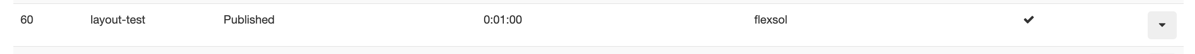

The name is under 50 characters for both the media and the layout. I found another weird behavior though. Everytime I edit, or publish a certain layout, its id changes . This i believe can cause huge problems since I won’t ever now the ID of my layout and subsequently won’t be able to fetch or perform any operations on my layout.
These are two images of the same layout, one before and one after publishing
