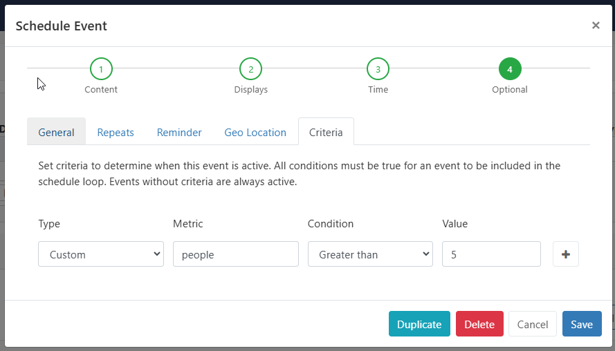

Example setup:
Schedule a layout with a custom criteria:
  • Type: Custom
  • Metric: people
  • Condition: Greater than
  • Value: 5
Then your external source can send a request to the CMS like this:
    "metric": "people",
    "value": "10",
    "ttl": 60
Since 10 is greater than 5, the layout will play at the next collection interval, or immediately if there are no other active schedules on the Player.
