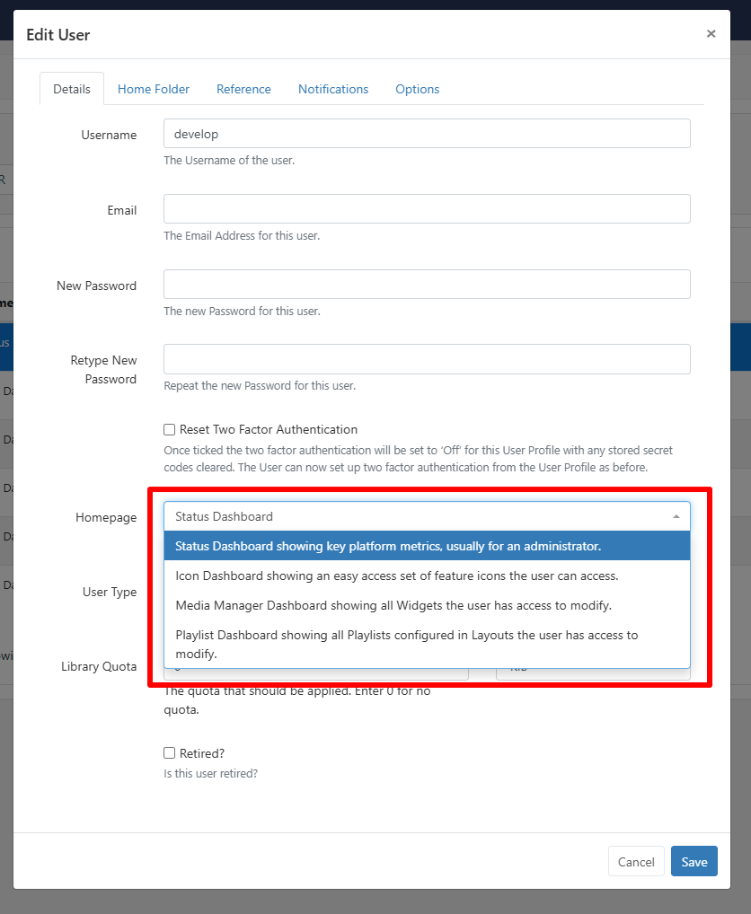

Here are the other accepted values for homePageId:
  • statusdashboard.view
  • icondashboard.view
  • mediamanager.view
  • playlistdashboard.view

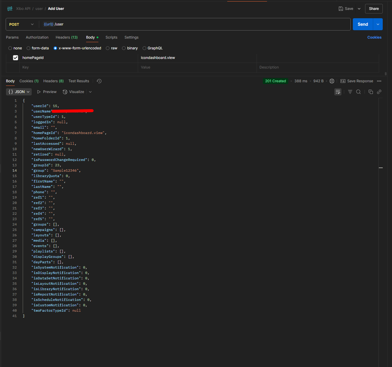

These correspond to the options in the Homepage dropdown in the User form, each with a short description shown in the image below:
As for the response, I tested this in Postman and the API returned data as expected on my end, as shown below:
I’ll review the Add User endpoint and the Swagger spec when I get a moment, as it’s still unclear whether the issue lies with the required parameters or the implementation.

Regarding the return data not being retrieved, my program was incorrect.
The schema listed in the api spec was large and there was a problem with the validation process.
I made the fix and all problems are now resolved.
