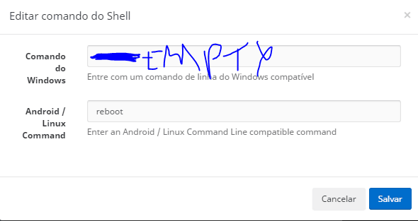

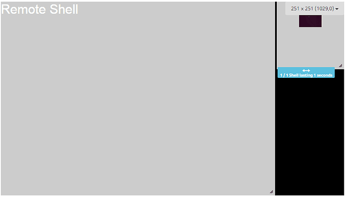

Hello Peter and Alex,
My equipment is all minix x5 mini, all are native to root firmware sent by minix with the customizations we ask.
Unfortunately I am struggling to run the shell module. I created the layout with two regions as tutorial with a text and a region and another with the shell command reboot.
The layout is downloaded by the equipment but not the reboot works. In the log appears msgs below:
What am I doing wrong?
