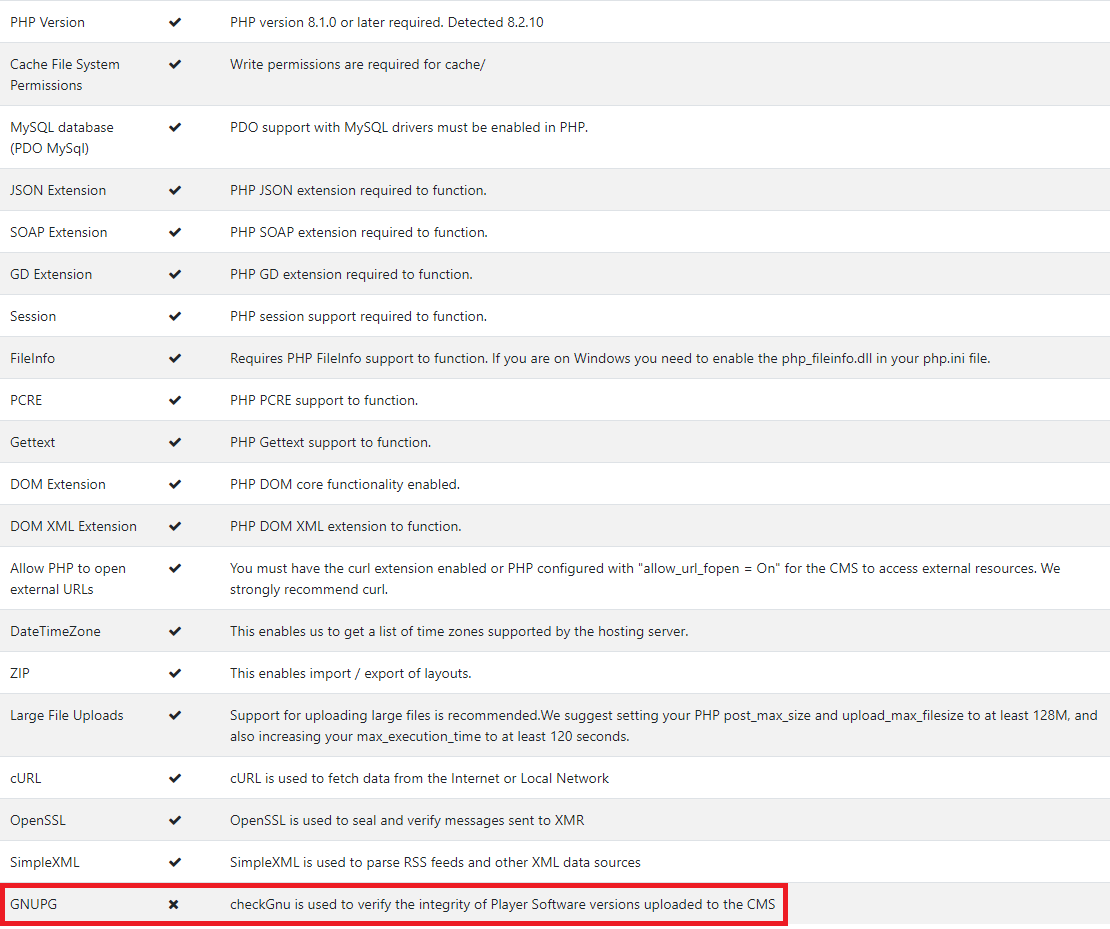

I’m installing the new release of Xibo CMS 4.2.1 to Windows Server 2022 - IIS. I managed to get all functioanalities working, however, when I launched install pages of the CMS, I can see that there is new extension called “GNUPG” that is required to be enabled in order to proceed with Xibo CMS installation. I did some some search on the internet and I cannot find and php_gnupg.dll that I can add to php\ext folder and then refer to it in php.ini
It seems also that this extension is not available for Windows. You can see the screenshot of XIBO install page below

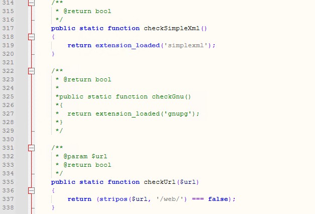

As you’re installing manually, you could edit the Environment.php file in lib/Helper and comment out the check for gngpg.

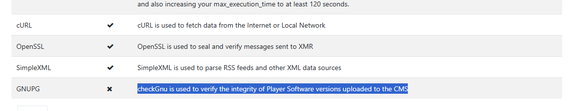

When I comment out the Environment.php file (jpeg 1) I get an error (jpeg2)
You’ve commented out the function rather than where its used; that’s my bad explanation, sorry.
