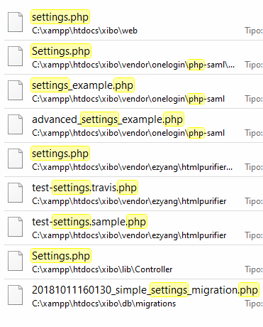

B. Make sure the xibo config file has the correct information for host, database, username and password. (Install Directory)/web/settings.php)

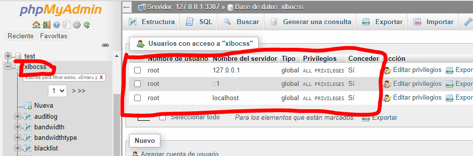

Are values correct according phpMyAdmin screenshot? Are B and C questions answered with this information?

Looks like your CMS is using username “userxibo” but according to the picture there is no user “userxibo” assigned to the “xibocss” database.This is your problem.
