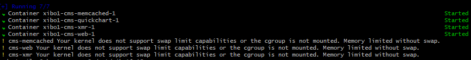

After saving the changes introduced in the cms_remote-mysql.yml file I have executed the command: docker compose -f cms_remote-mysql.yml up -d. The installation process has started but it has given an error:
 ! cms-memcached Your kernel does not support swap limit capabilities or the cgroup is not mounted. Memory limited without swap.                                                                                                    0.0s
 ! cms-web Your kernel does not support swap limit capabilities or the cgroup is not mounted. Memory limited without swap.                                                                                                          0.0s
 ! cms-xmr Your kernel does not support swap limit capabilities or the cgroup is not mounted. Memory limited without swap.
![imagen|690x82](upload://60AvHDFLvXRYboyaeFejHlcnEi4.png)
What could be the problem? Using phpmyadmin I have accessed to the database. A lot of tables have been created in the database. I think the problem is not the remote database access..
Could you help me? Thanks
I send a screenshot:

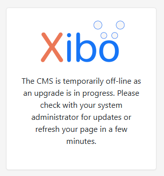

    No errors but when loading the CMS a page displayed:
    The CMS is temporarily off-line as an upgrade is in progress. Please check with your system administrator for updates or refresh your page in a few minutes.
    Can someone help me?
