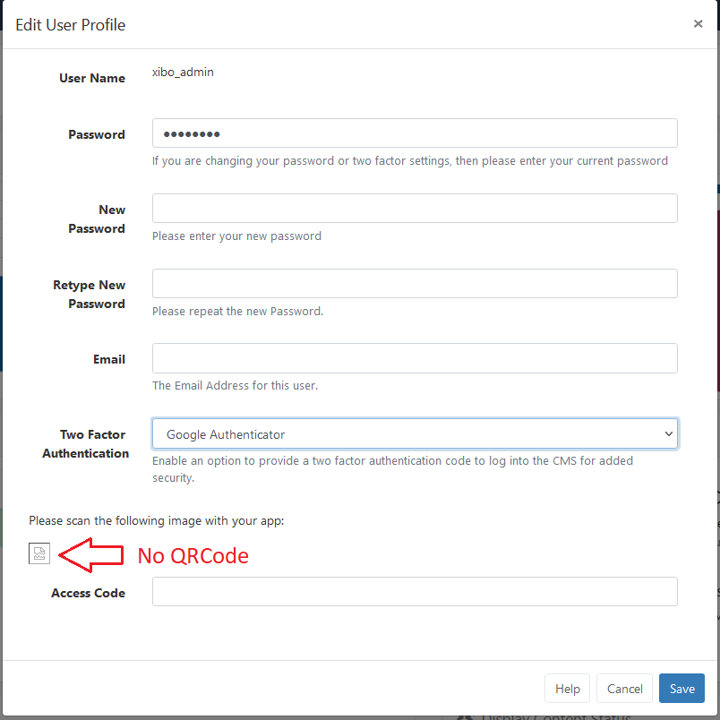

Enabling two factor authentication doesn't show QRCode
Hello team !
When I try to enable TFA with Google Authenticator, an error occurs when generating the QRCode image :

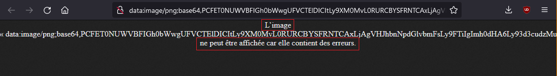

If I try to open the image, Firefox tells me it can’t open because it contains errors :
Google Chrome behaves the same.

The one that doesn’t work is an error message from your proxy server.
You probably just need to add cms-quickchart to your proxy exceptions in the main CMS configuration - since you’re talking to a local container that doesn’t need to go via your proxy server.
