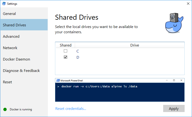

Depending on how you have Docker setup on Windows (Toolbox vs Docker for Windows), if you’re using Docker for Windows, you’ll need to share your C: drive with the Docker VM so that we can write persistent data.
There’s a guide here:
