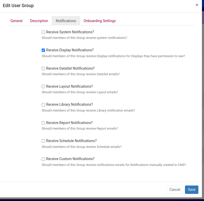

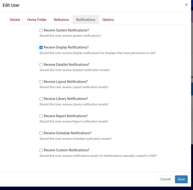

We successfully tested the password reminder functionality by following these steps:
  1. User Creation: We enabled the password reminder feature in the settings (1), provided the admin email address in the network tab (2), and created a user with the same email address (3).
  2. We also set the User Group Notifications to receive system notifications (4).
  3. Password Reset: We then attempted to reset the password for the user with the same admin email address.
Result: The system successfully sent a reminder email to the admin inbox, confirming that the password reset process was working as expected.
Image 1
Image 2
Image 3
Image 4

Thank you for providing detailed information about your setup, Alex. Based on what you’ve shared, it seems that most of your configuration is correct. However, there are a few things we can check to troubleshoot why you’re not receiving offline display notifications:
  1. The normal behaviour is that you should receive notifications when a display goes offline and when it comes back online. Reference
  2. Check your CMS Settings on the Maintenance tab to ensure that Email Alerts are enabled and properly configured.
  3. Verify that the Max Display Timeout setting is appropriate for your setup. This determines how long a display can be offline before an alert is sent.
  4. Confirm that the Admin email address and Sending email address are correctly set up in the Network tab of the CMS Settings
  5. For individual displays, make sure that Email Alerts is set to “Yes” on the Maintenance tab of the display settings.
  6. Enable the Notifications feature set for the Users and User Groups in the Notifications tab
  7. Check CMS Logs: Look for any error messages related to sending emails or display notifications
Hi Alex,
After investigating further, it seems that only the display offline email notifications are being sent, and the online notifications are missing. We have logged an issue for this bug.
We recommend checking for any updates or fixes related to this bug in future versions. You can track the progress on this issue here: Email: Not receiving emails when display becomes online · Issue #3611 · xibosignage/xibo · GitHub
