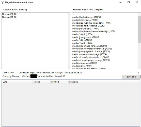

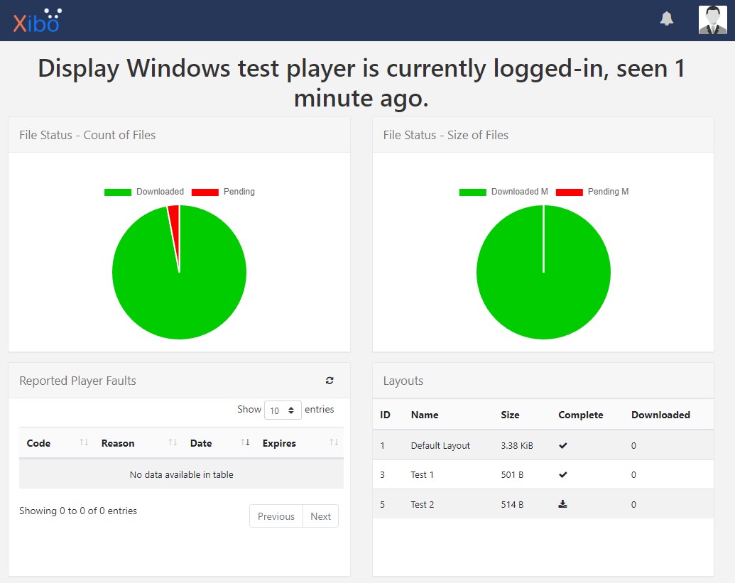

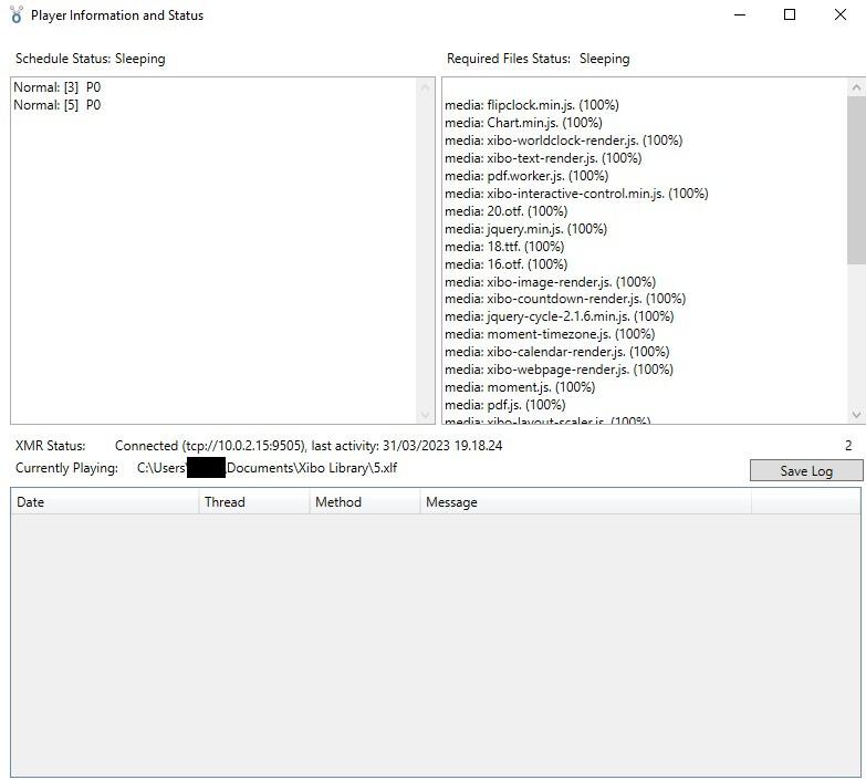

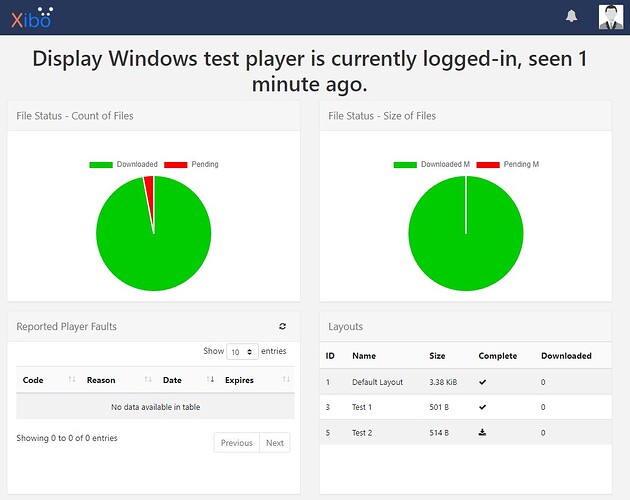

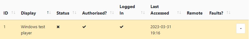

I’m having a weird problem with the CMS showing the X status for the display even though the player has downloaded all the files and showing the content correctly. This happens after display authorisation with the default layout as well as after scheduling actual content. When I quit the player and start it again the status will change to tick and green until the next change in layouts or scheduling. When I go to the manage page of that particular display I can see that the most recent layout is in a downloading state but still the player plays it correctly.
This is a test environment in VirtualBox and I have tested the following versions all of which act the same.

The “X” indicates that your device is currently downloading the content you assigned to it.
This “status” column refers to the content assigned to the device, as follows:
CLOUD ICON: Device is pending update or synchronizing with the CMS.
“X” ICON: Content download is in progress.
CHECK ICON: Content fully downloaded.

Thanks for your reply. I am aware of the meaning of those icons since we also have a production environment in which everything is working ok.
The collection interval is set to 5 minutes but even after hours of operation the status is still stuck in X. Not expected behaviour and very odd that it only happens in the test system.

The default layout starts playing but the display status remains in X
Restarting the player software changes the status to green. But as soon as I add another layout to the schedule the status goes to X again. The content always plays without issue and according to the schedule.

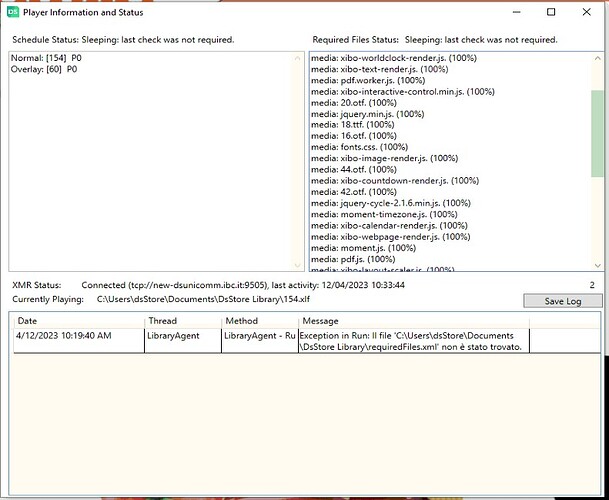

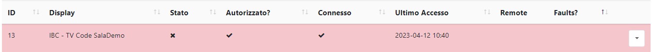

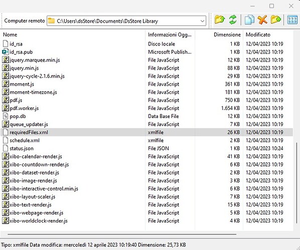

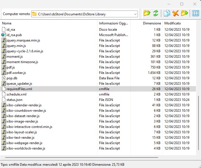

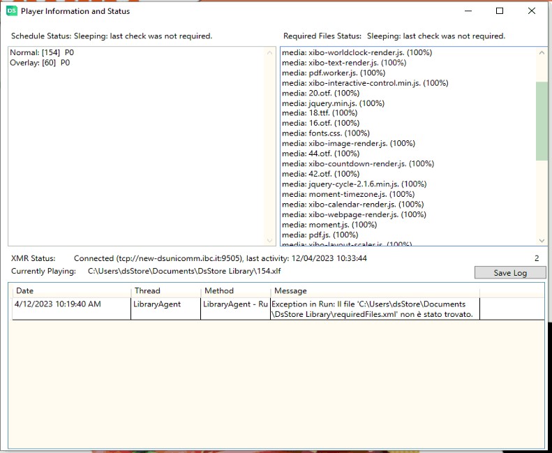

Hi everyone, I have the same issue: when I send a layout to a group of displays, the display appears with an incorrect status as shown in the following image, but in reality it has downloaded all the files and is working properly.
