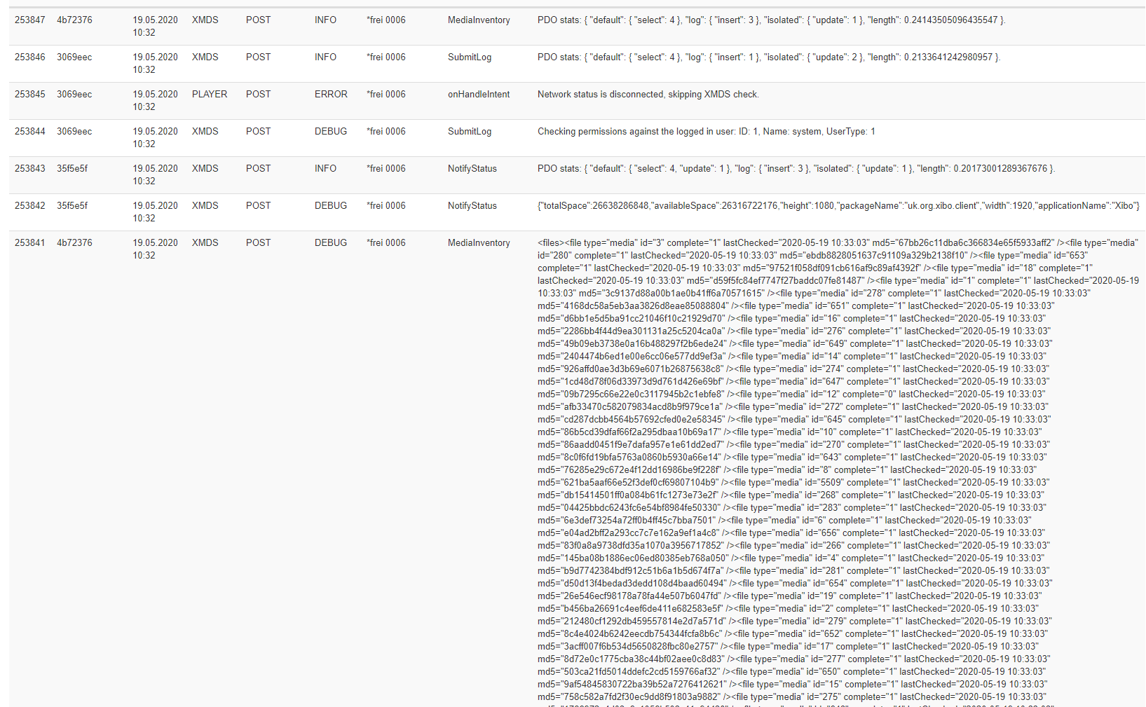

and this is the screenshot of the log:

Thank you for your reply and the screenshots
Unfortunately the screenshot from the logs doesn’t show the Status screen which you can get following those instructions : https://xibo.org.uk/docs/setup/getting-the-player-status
If you tried to access the Status screen via the CMS> logs as described in the provided link the please note that on step 7, in Logs you need to search NotifyStatus in the Page field.
Also you haven’t confirmed the Display download Window?
