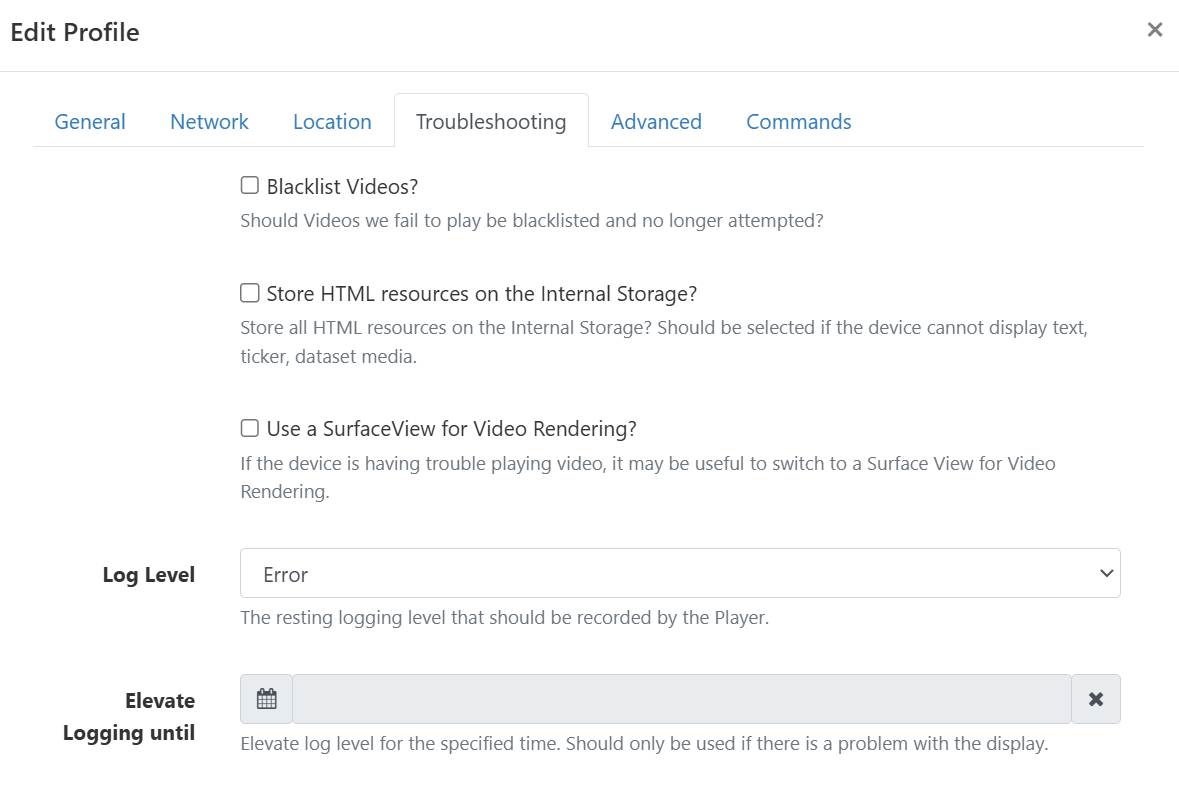

Display logging
Display logging can be configured on either the Display Settings Profile for your Player type, or in the Display Settings Override tab on Edit Display. This is done by setting the **Elevate Logging until" option.
The type of logging available depends on the Display and can be set from within the Display Settings Profile, or overridden on the Display.
Once you have made a change to the log configuration, the Display will switch to that level the next time it connects to the CMS for its routine collection.
