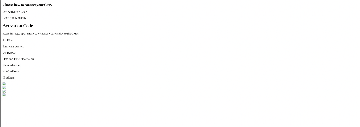

ChromeOS now displays something which is better then what we had before

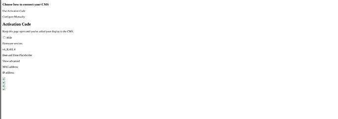

I’m still tinkering with nginx to see if I can get the right config, but for now still broken :frowning:
