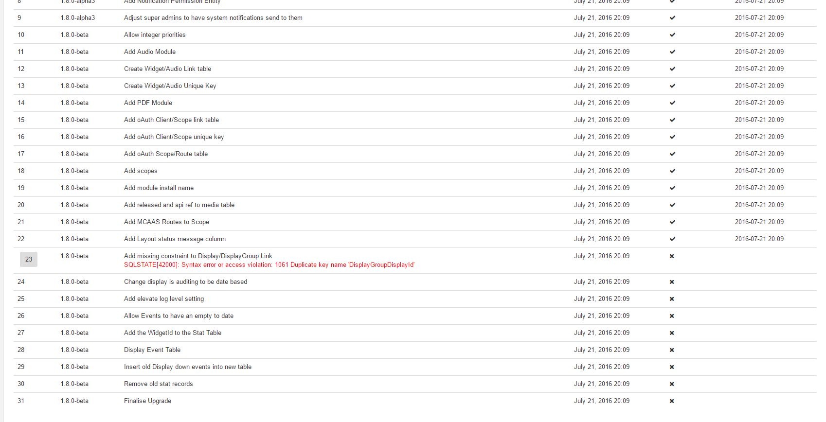

Upgrading from Alpha3 to Beta I ran into this:
Not exactly sure what to do about that yet.

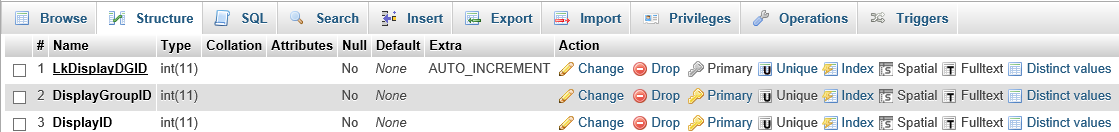

I do see LkDisplayDGID that is set to unique. I am not sure if the column needs a name change or what the issue is.
Please let me know.

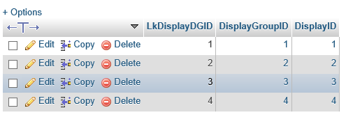

UPDATE: Since the table had very little data in it, I copied down the data, and then dropped the table. Looking at 125.json and structure.sql, I decided to recreate the table with the following:
CREATE TABLE IF NOT EXISTS `lkdisplaydg` (
  `LkDisplayDGID` int(11) NOT NULL AUTO_INCREMENT,
  `DisplayGroupID` int(11) NOT NULL,
  `DisplayID` int(11) NOT NULL,
  PRIMARY KEY (`LkDisplayDGID`),
  KEY `DisplayGroupID` (`DisplayGroupID`),
  KEY `DisplayID` (`DisplayID`)
) ENGINE=InnoDB  DEFAULT CHARSET=utf8 AUTO_INCREMENT=1 ;
I left out
UNIQUE KEYDisplayGroupDisplayId (DisplayGroupID,DisplayID),
The upgrade proceeded to the end. Will this pose a problem?, if so should we just reload from scratch?
I repopulated the table, and when I logged in I saw all my screens.
