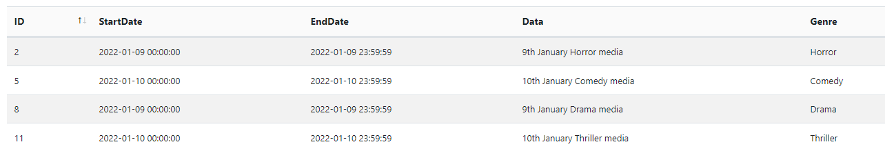

I created a simple layout and dataset that has a filter statement which could be helpful to your use case.
For the dataset I added some date rows to filter by as well as a genre and data column:
In my dataset ticker I used the following statement:
NOW() > StartDate AND NOW() < EndDate AND Genre = "Horror"

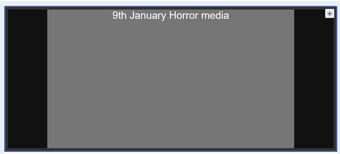

The statement returned only the data row that is between the current start and end date (tested on 9th January in case you see this post at a later date) and also the matched the genre:
I hope this helps you with the setup you are looking to create.
