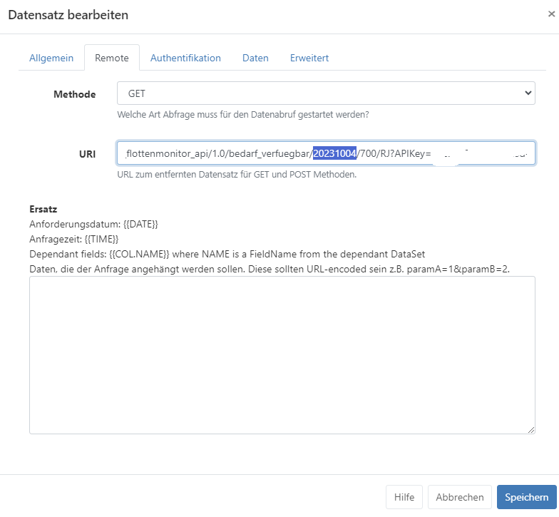

No, I need the dataset url:
here the url needs the date - i marked it.
when using {{DATE}} it replaces it with 2023-10-04 but I need 20231004 without the hyphen.
I think that this is not possible and I need to search for an alternative…

I tried creating a column that formats the date as needed and then using {{COL.NAME}}
for it does not work because I do not understand how to use it…
Hi @embedit , in order to use the {{COL.NAME}}
replacement you would need to create a separate dataset containing the formula column that formats the date as needed. You would then need to add a single row to this new dataset.
Next, Edit the original Dataset and navigate to the Advanced tab. Click on the drop-down for ‘Depends on Dataset’ and select the new dataset containing the formula, then click on Save.
Now you can add {{COL.NAME}}
into the URL where NAME is the name of the formula column in the dependent dataset.

Hi Frazer,
Thank you, this is a solution.
Now it is running without the “hack”.
I tried the same thing, but with a column in the same dataset. This is not working.
