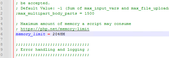

Try increasing the PHP memory limit and then rerun your tasks:
PHP.ini
memory_limit = 2048M
For example, my PHP configuration is set to use 2 GB of RAM:
Note: if your tables are larger than the PHP memory limit, the tasks will fail.
If that doesn’t work, try running them one at a time.
I had mem set to 2000, but I doubled it (has a total of 8gb available) to see if it works.
How do I run them one at a time? Though the GUI? Under Tasks? When I click “Run Now” on any of them I get a green success message but nothing else changes and there is still no “Last Run” timestamp.
