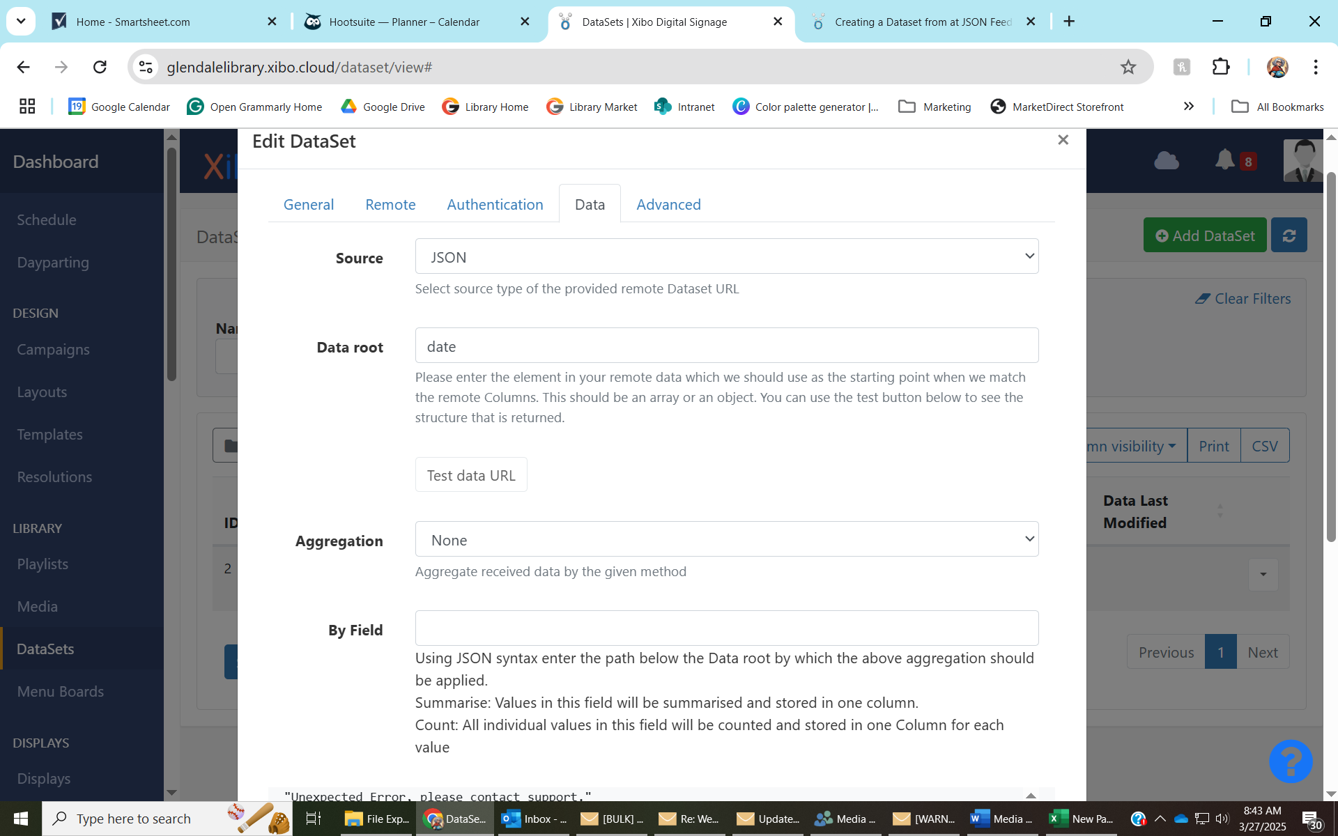

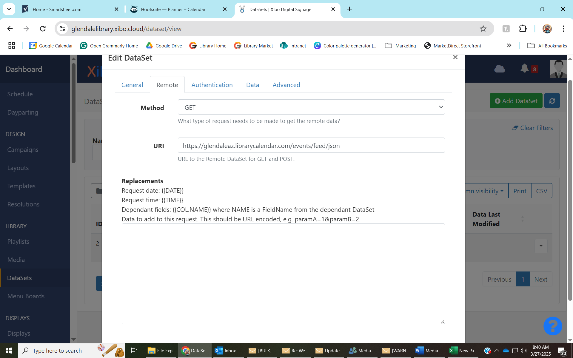

Hi, I am trying to create a dataset from a JSON feed.
https://glendaleaz.librarycalendar.com/events/feed/json. I want to use it to create a widget to pull upcoming events from my library’s calendar.
The calendar widgets won’t display the location properly, reverting to the address, not the name of the library.
I followed the steps in the guide but I get the message “No Data Available in Table”. I’ve tried troubleshooting and something must be wrong in my configuration, but I can’t find the error.
Also, if possible, I’d like to pull events 3 weeks out from the current date.
Rather than posting the json, I recommend viewing it at JSON Parser Online to parse JSON. It is very long.
Here are screenshots of my configuration. Any and all help is appreciated.
Thank you!
Merideth

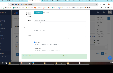

Here are the screenshots, hopefully they are easier to read -
In case those don’t come through,
In the Remote tab, I have the method set to GET and the URL is
In the Data tab, I have
Source: JSON
Data root: DATE (because I believe there is no name for the array?)
Aggregation: None

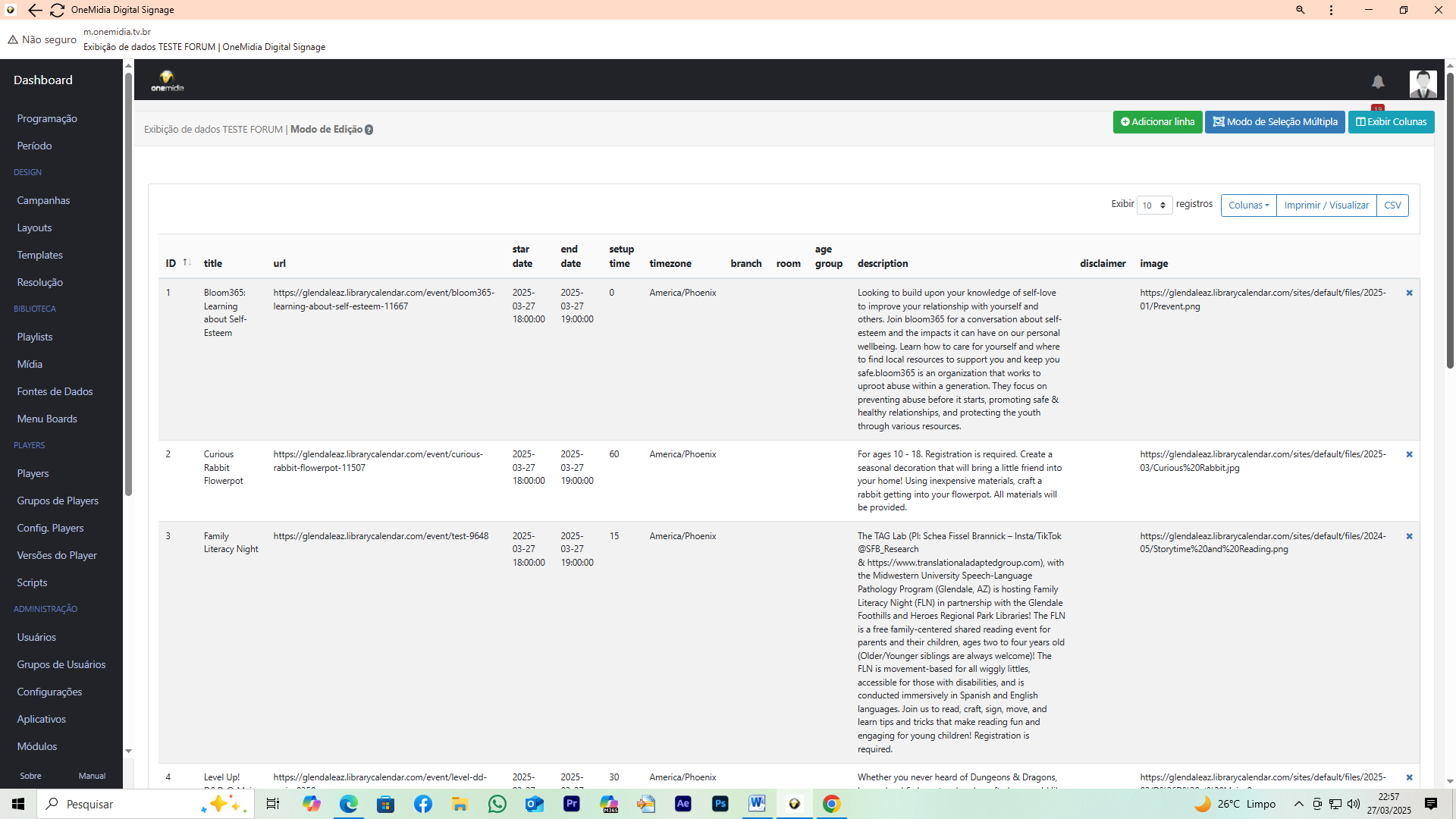

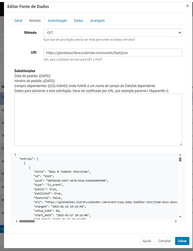

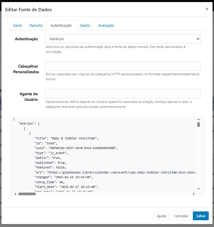

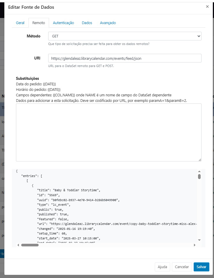

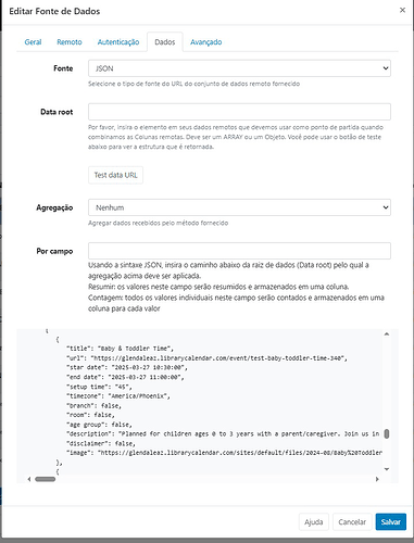

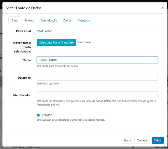

Hello, Merideth!

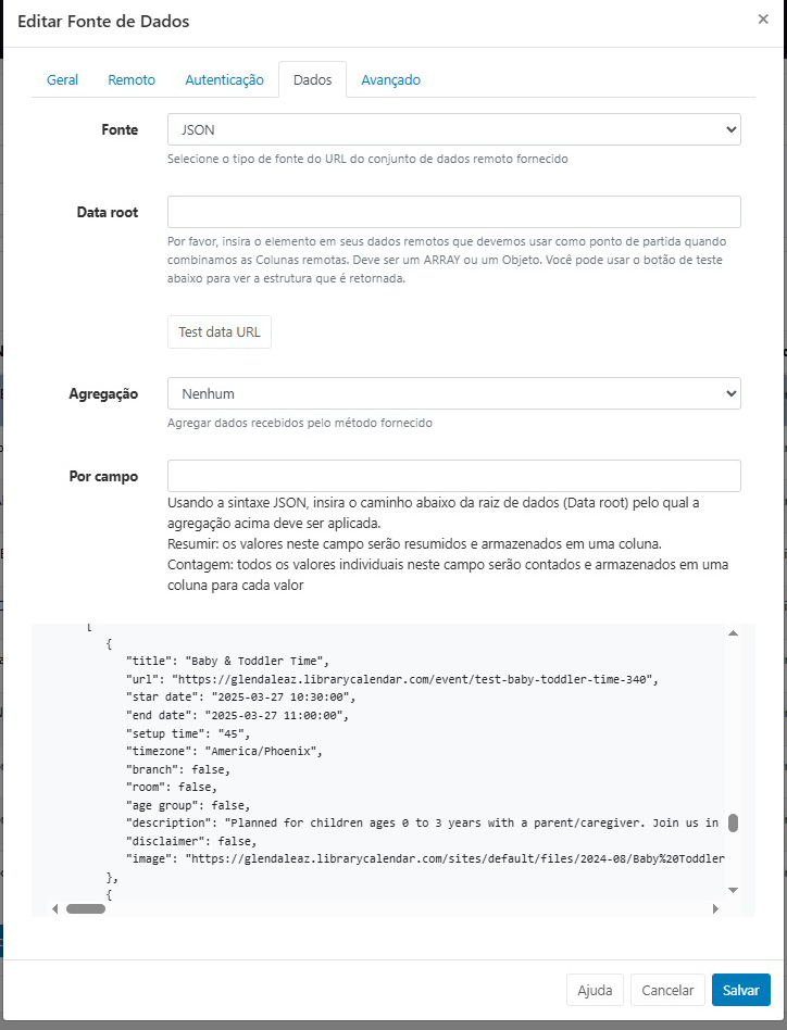

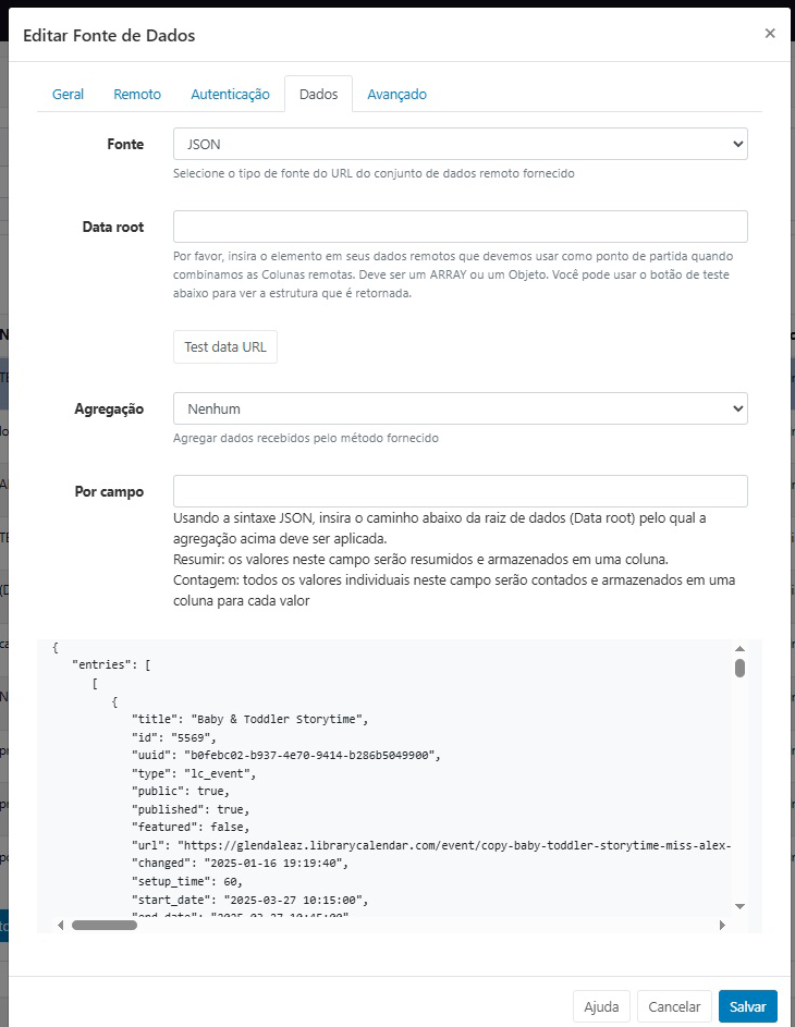

I successfully extracted the data, and here are the screenshots of the sequence.
The first screens show the original raw data, while screen 6 displays the selected data, now processed and properly formatted.
If you need any further information or adjustments, feel free to reach out!

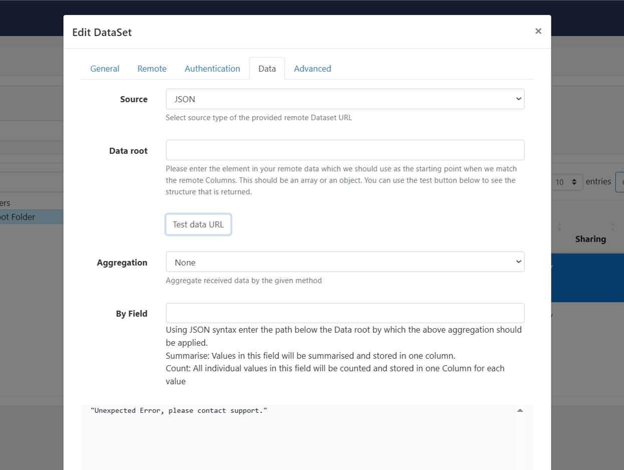

Hi!

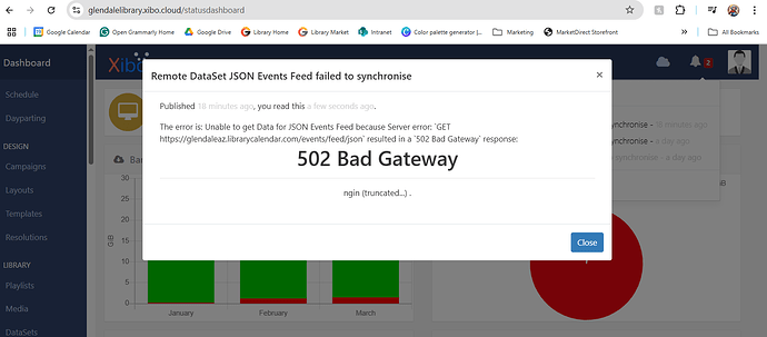

Thank you, I set it up following your screenshots, and I get the following message when I test the URL
"Unable to get Data for JSON Events Feed because Server error: GET https://glendaleaz.librarycalendar.com/events/feed/json resulted in a 502 Bad Gateway response:\n\r\n502 Bad Gateway\r\n\r\n
502 Bad Gateway
\r\n
ngin (truncated…)\n.
Am I right in thinking that’s a problem on the end of my vendor?

json link works fine, are you connecting over proxy ?
This message also appears here, but just wait about 20 seconds, and the result will be displayed.

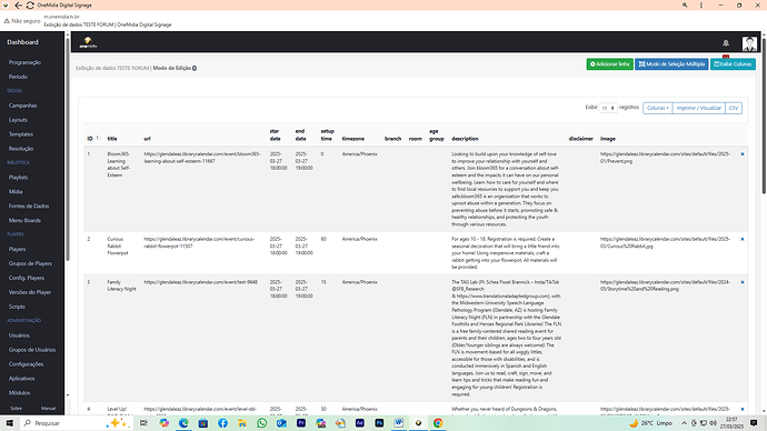

The “502 Bad Gateway” error usually indicates a problem with the provider’s server. It may be temporary, so just wait a few seconds, and you will receive the result.
Here is the screenshot of the extracted result.
No, I’m not using a proxy. I’m only using a dedicated server for the connection.
i was refering to this nginx 502 Bad Gateway, bad proxy configuration?

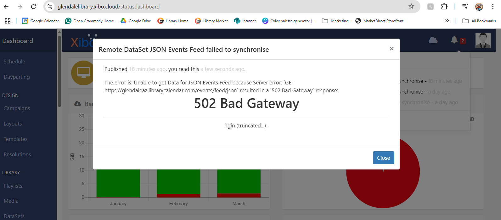

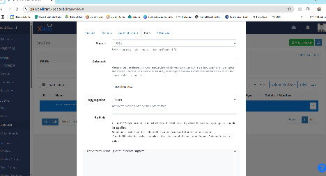

When I test the data URL I get the screen below
what is your result on:
  1. ping server
  2. try wget/curl file
  3. open it in browser
  1. ping server - Ping server, ping website : Check host - online website monitoring
  2. I’m not sure what that is :slight_smile:
  3. It opens in Edge but I get the bad gateway message in Chrome

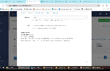

On the CMS I get this message -
so disband chrome, use edge
this is not xibo problem, learn proxys on your networks
