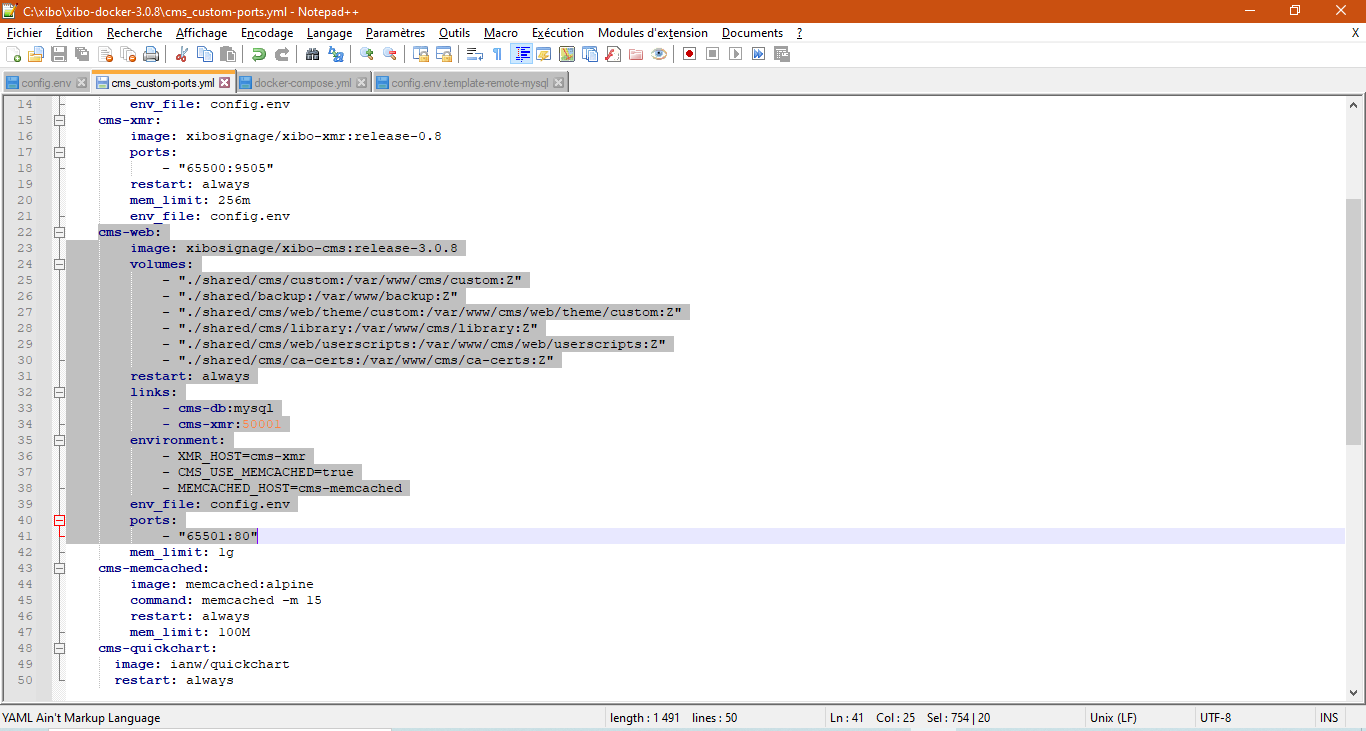

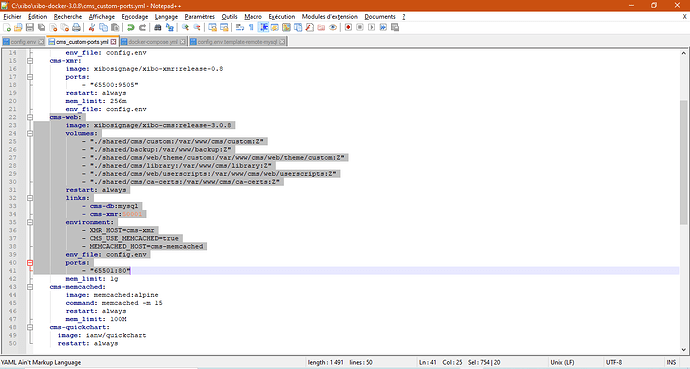

Hello team, I have this error. After running the command docker-compose up -d for installing the CMS.
Can somebody help me please. Thank
Error response from daemon: driver failed programming external connectivity on endpoint xibo-docker-308-cms-web-1 (7922e39bb90dbb77b81d09d1eb0d847f12afafe8a6716d06b35ab34c3d3ed7e8): Bind for 0.0.0.0:80 failed: port is already allocated
PS C:\xibo\xibo-docker-3.0.8>

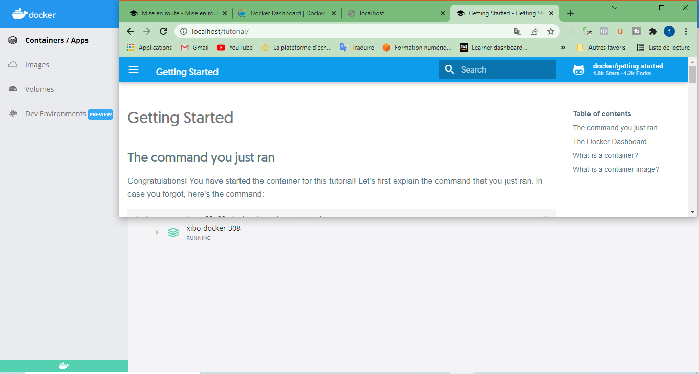

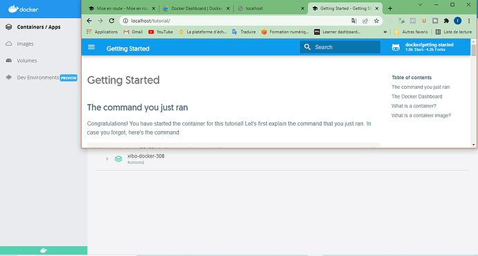

Because port 80 is already in use on your machine where you want to run this container.
Specify a different port or remove the app that is using port 80.
