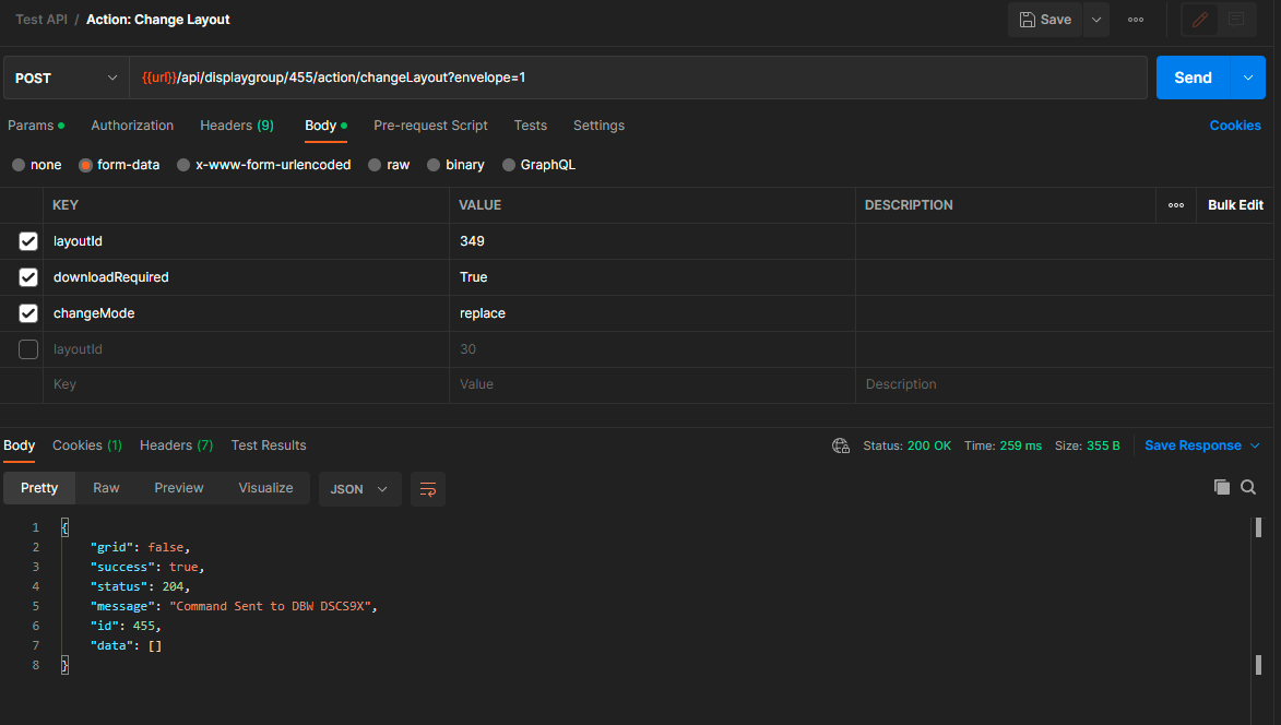

Here is an example of how I use the change layout API call for my display:
You can see I have set downloadRequired to True as I do not have a copy of the layout stored in the local library for my display. I am also using the replace value for the changeMode parameter.
Because XMR is configured and running for my display the change is very quick and I see the layout appear on my display once.

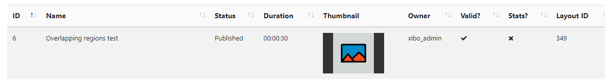

Please can you make sure you are using the correct layout ID? On version 3 CMS instances this can be found by going to the Layouts menu in your CMS, then click the column visibility button and select Layout ID. You can see in my screenshot that the layout ID is not the same as the ID column:

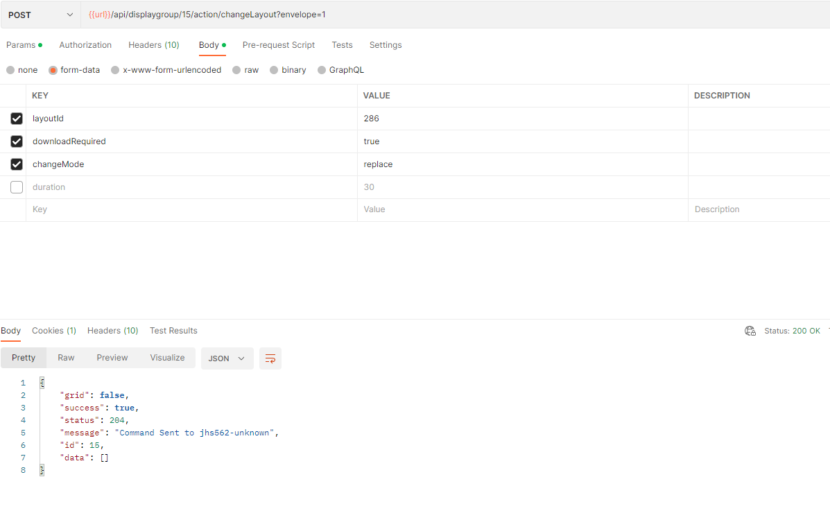

Thanks for sharing the info, here is the postman setup
I can send the Screen Capture request successfully but when requesting Change Layout getting no response

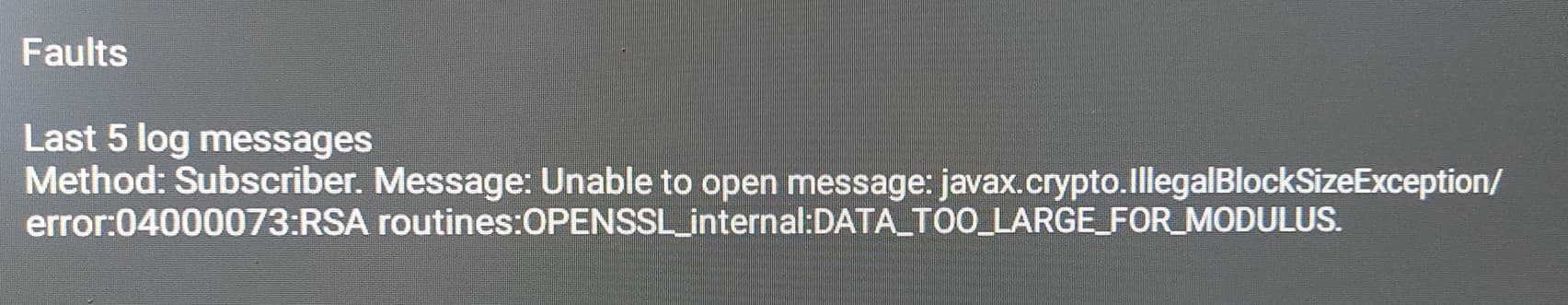

I noticed this error on Android player, is that any related to the Change Layout call? it appears when I post the API call
