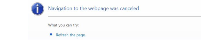

In addition to the above two patterns, the following stop patterns were confirmed.
・ The following is displayed in the data set ticker field.
“Navigation to the webpage was cancelled”
